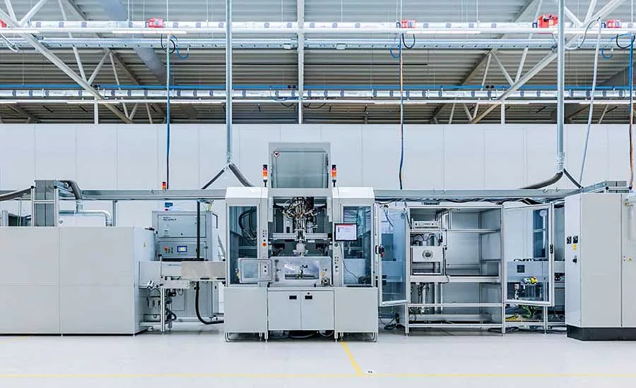

Bdtronic recently designed a fully automated production line for potting the shift ring on a motor stator. Photo courtesy Bdtronic GmbH

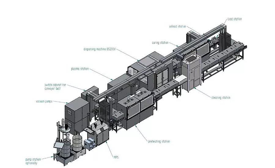

The line consists of an infrared preheating station; a cleaning station; a low-pressure plasma unit for surface activation; a B5200-V vacuum dispensing cell with a dynamic mixing head and three-chamber vacuum technology; an infrared curing station; a conveyor; and a loading and unloading station equipped with a six-axis robot. Photo courtesy Bdtronic GmbH
Extensive testing determined that a dispensing rate between 1 and 3 grams per second was optimal for series production. Photo courtesy Bdtronic GmbH
The dispensing cell processes a highly filled two-component epoxy. A dynamic mixing system guarantees the highest mixing quality, even with large viscosity differences, difficult mixing ratios and processing times of less than three minutes. Photo courtesy Bdtronic GmbH

German automation and dispensing technology company bdtronic recently designed a fully automated production line for potting the shift ring on a motor stator. Built for a major German Tier 1 automotive supplier, the line combines different technologies, achieves the shortest possible cycle time, and meets the customer’s requirement for a small footprint and efficient use of resources.

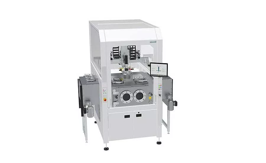

The line consists of an infrared preheating station; a cleaning station; a low-pressure plasma unit for surface activation; a B5200-V vacuum dispensing cell with a dynamic mixing head and three-chamber vacuum technology; an infrared curing station; a conveyor; and a loading and unloading station equipped with a six-axis robot. RFID technology and a manufacturing execution system track assemblies throughout production.
Vacuum Dispensing
The dispensing cell processes a highly filled two-component epoxy. This material is used wherever protection against heat and the elements is required. The epoxy must be precisely mixed and metered at a specific mixing ratio and process temperature. The dynamic mixing system guarantees the highest mixing quality, even with large viscosity differences, difficult mixing ratios and processing times of less than three minutes.
The material preparation system ensures that the resin is continuously circulated, tempered and bubble-free under vacuum (below 10 millibars). The material preparation system does not have to be stopped for refilling, so the system can operate continuously if needed.
The material is dispensed volumetrically by a pump with eccentric screws developed by bdtronic. A temperature management system with different heating zones in the material feed and mixing head ensure optimal dispensing. Extensive trials at bdtronic’s Technology Center determined that a dispensing rate between 1 and 3 grams per second was optimal for series production.
Parts with three-dimensional contours can be accommodated thanks to a precise, servo-driven gantry system inside the vacuum chamber.
The vacuum plasma unit was integrated so that the temperature loss of the preheated components is as low as possible. After potting the stator rings, the epoxy is annealed in the infrared curing unit, so the components can be handled for further processing.
Infrared technology offers several advantages. Four preheating positions can be used, and processing time is minimized. The unit has a relatively small footprint, and energy consumption is significantly less than convection ovens.
