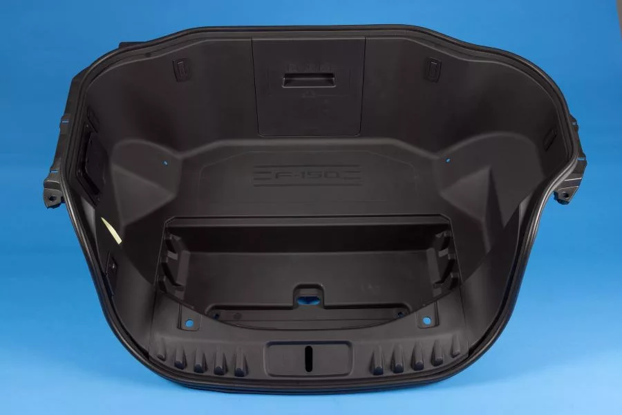

The Ford F-150 Lightning won the Grand Award. It also was the Body Interior Category winner for the frunk (photo above) located at the front end of the vehicle. Suppliers of the part include Cascade Engineering Inc. and Celanese Corp.
By converting from compression molded painted SMC to injection molded MIC LFT-PP to produce this large Class A composite frunk (currently the industry’s largest), mass was reduced 48 percent. In addition, productivity was increased due to a 37 percent cycle time reduction. The cost and environmental burden of paint were eliminated, seal interfaces were improved, secondary routering of holes is no longer needed and the frunk is fully recyclable at end of life. A 4,000- ton injection press and a tool equipped with a 16-drop hot runner system are used to mold parts.
