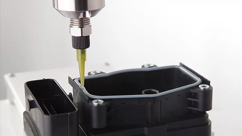

More Efficient Dispensing
When dispensing liquid sealant, it’s important to apply the material precisely along the contour of the part. However, on complex components with various corners, radiuses and surfaces, consistent, gap-free dispensing can be challenging.
To address this issue, Scheugenpflug GmbH recently developed the DC803 Dispensing Cell. It is designed to make the gasket dispensing process faster, easier and more reliable.
Software enables dispensing speed to be adapted to the gantry speed. Since the gantry can accelerate on straight sections, dispensing speed is automatically increased at the same time. “Similarly, the gantry slows down along tight radiuses, so dispensing is adjusted to prevent material from accumulating,” says Sebastian Schmitt, area sales manager at Scheugenpflug. “The process time can be significantly reduced as a result of this direct link. In some applications, it is reduced by up to 50 percent.
To ensure optimum and traceable quality, vision systems are used to check the width, position and uninterrupted application of the sealant during application. There is no need for a separate inspection station, which saves money and cycle time.
Vision sensors are mounted directly on the dispensing head above the nozzle. Inspection is performed in real time as the sealant is applied, so plant personnel know immediately whether a part is good or not good.
“Inspection with RTVision is available with 2D or 3D sensors,” explains Schmitt. “The 2D sensor uses an LED light source to detect the width and continuity of the application by contrasting the bead with the background. The 3D sensor uses six lasers as the light source to evaluate the third dimension, height, as well.”
User-friendly software lets engineers easily enter the parameters for good parts and bad ones. Detailed visualization means that the status is instantly visible.
