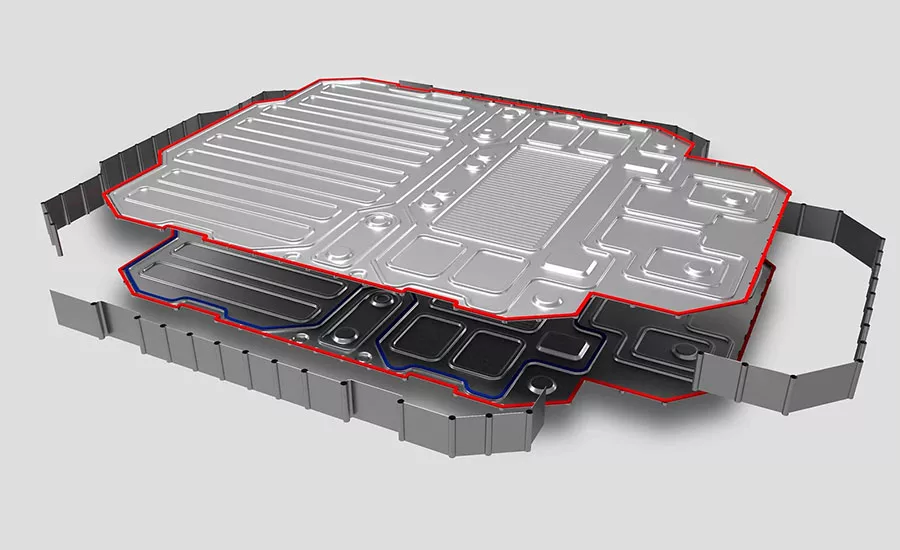

EV battery compartments must be sealed against water, dirt and other contaminants.

EVs are powered by lithium-ion battery packs that are typically underneath the car. These battery packs are housed in watertight enclosures designed to protect them from exposure to moisture, road debris, and other external elements. Automotive manufacturers test EVs for water resistance, ensuring they can operate safely in rainy or wet conditions. However, design limits are typically exceeded when EVs encounter severe flooding.
When the vehicle is wholly or partially submerged in water, particularly saltwater, the integrity of the battery enclosure becomes critically important. Water penetrating the enclosure can compromise the battery’s function and safety. Flood waters will contain a complex soup of elements, even away from the ocean.

  •  Waterproofing. Battery enclosures are designed to meet stringent ingress protection ratings, often IP67 or higher, meaning they can withstand temporary submersion in water. This protection is critical for avoiding water intrusion during floods.

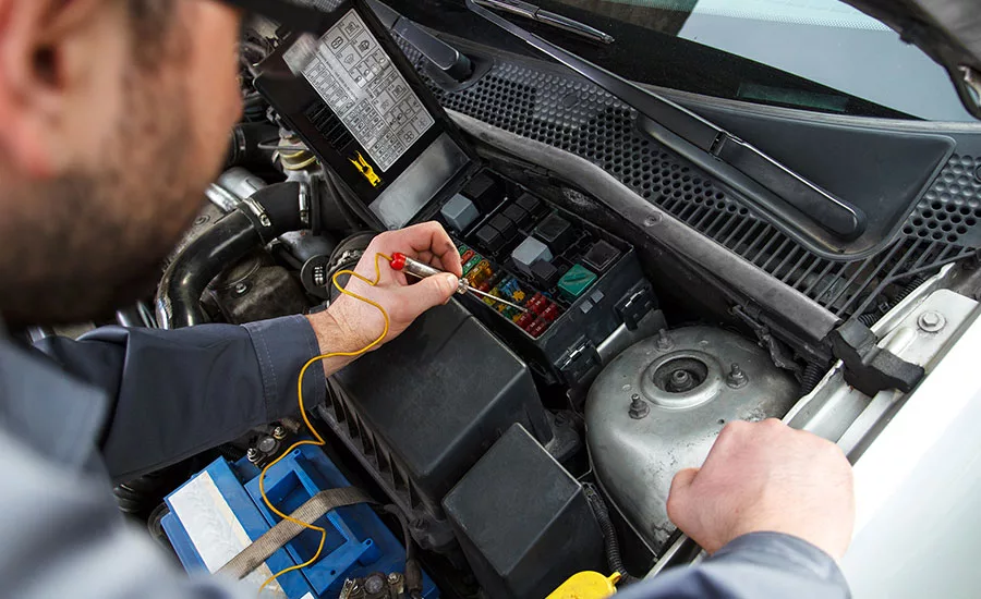

Inspect after exposure. If your EV has been exposed to flood waters, it’s critical to have it inspected by a professional before attempting to drive it. Even if the car appears to function normally, hidden water damage can lead to severe problems later.
