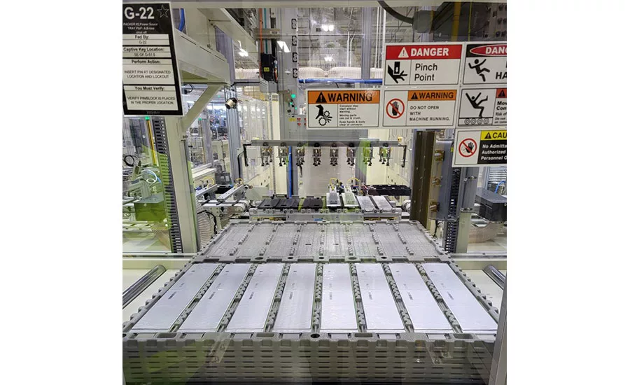

Photo courtesy Ultium Cells LLC
Ultrasound technology enables engineers to peer deep inside EV batteries.
