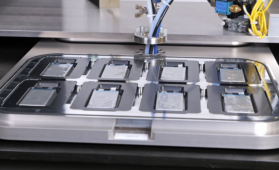

Because eight parts are tested simultaneously, line speed is achieved for a cycle time of 12 to 15 seconds. Photo courtesy Inficon

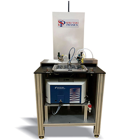

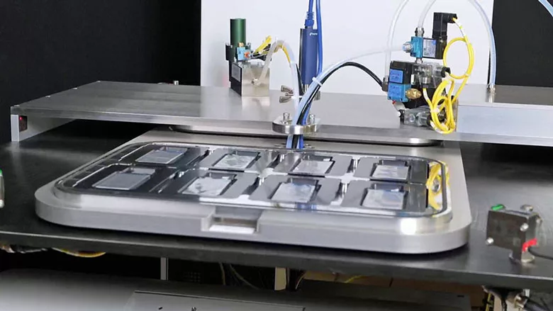

To achieve throughput requirements, Spectro Physics designed a system that integrated an Inficon ELT3000 to test eight batteries at a time. “These were relatively small batteries, so testing eight of them at a time wasn’t a problem,” Williams explains. “We would load those eight batteries into the test chamber, rotate the test chamber [a two-station clamshell] and then lift it up into position for testing.”
Evacuation to test pressure occurs rapidly, “but we had to hold on to it for a little bit under vacuum to allow the electrolyte to start leaking out.”
Though inherently slow, because eight parts are tested simultaneously, line speed is achieved for a cycle time of 12 to 15 seconds.
“We provide sufficient time to draw the gases that are in the test chamber into the gas detection unit, and it can report and tell us what the leak rate it was able to read. Then we would attach it to the status of the part and come up with a [test result for] the part,” Williams says.
There were challenges, such as electrically pre-charged cells. For this customer, Spectro Physics designed insulated test chambers to prevent shorts. Also, if even one of the eight tested batteries fails, the entire batch must be retested, according to the customer’s specification.
“It’s part of the nature of the beast where we must allow some time for the electrolyte to start leaking out of the battery before we can start detecting it. Because of that, it is never going to be a one-for-one test, like we do in the airbag inflator business,” Williams says.
