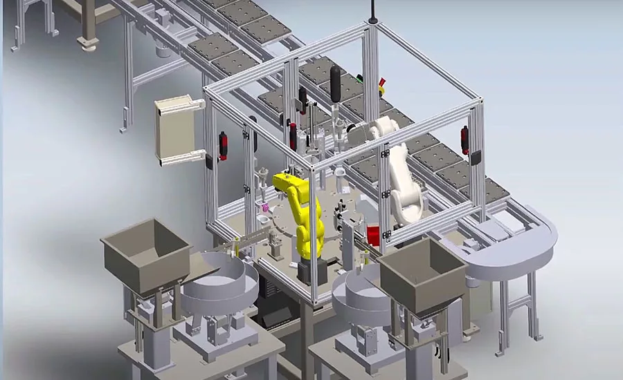

vibratory bowl feeder
Vibratory bowls feed the components into the system.

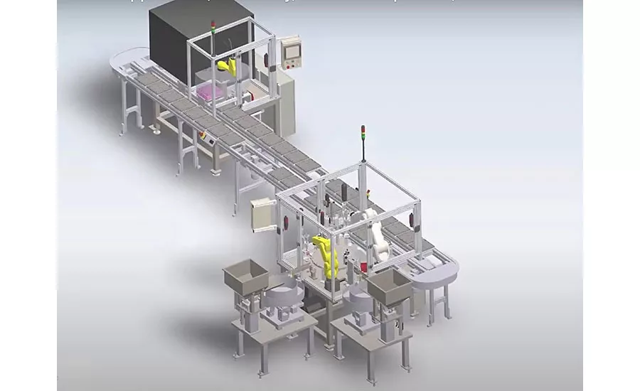

assembly and marking
The system consists of two halves: one assembles the parts, the other tests and marks the assemblies.

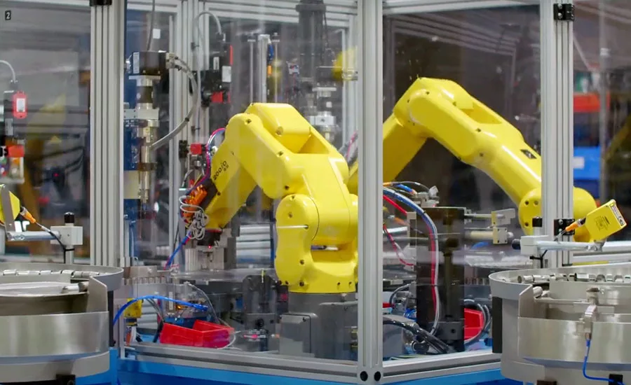

automated pick-and-place
Two six-axis robots handle pick-and-place duties in the assembly cell.

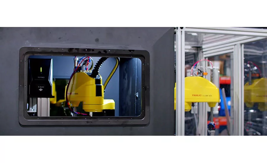

Two SCARA robots handle pick-and-place duties in the test cell.

The automated assembly process features several creative, high-precision designs. It begins with vibratory bowls, which feed the components into the system. This allows the system to adapt to variable part orientations despite the complex geometries.
In the first half of the system, a rotary indexer transfers assemblies from station to station. Six-axis robots pick and place the components to ensure they are properly aligned for the adhesive dispensing system. Accurate alignment is crucial to the assembly process. Between applications, the indexer is moved to prepare the next component in line.
After the adhesive is dispensed, the two cans are joined. The assembly is assisted by forming stations that consistently create a tight fit for the parts. Two six-axis robots complete the joining process of the components.
The assemblies are then placed on a pallet. This pallet is on a conveyor that takes the assemblies in and out of the automated testing and marking stations.

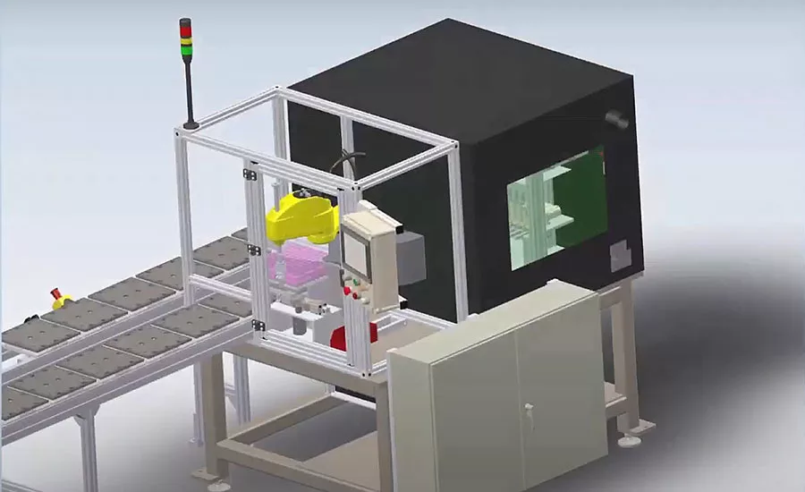

In this half of the system, a pair of SCARA robots transfer the assemblies from the pallets to the testing and marking equipment. Thermal testing is necessary to ensure that the assemblies can operate within specifications. Whenever an assembly passes the thermal test, it is laser-marked as a good product. From there, it is returned to the conveyor. The laser also engraves a serial number on each assembly for tracking purposes.
