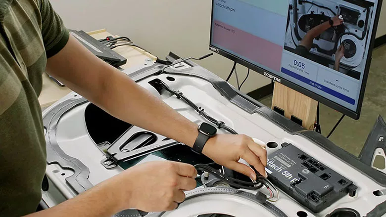

real-time guidance and monitoring
AI technology provides real-time guidance and monitoring for operators. Photo courtesy Dori Inc.
“The biggest advantage of using AI on manual assembly lines is its ability to provide real-time guidance and monitoring, ensuring operators follow standard operating procedures precisely,” says Nitin Gupta, Ph.D., vice president of Dori Inc., which has developed a no-code digital platform called Dori AI. Using computer vision and deep learning video analytics technology, the system monitors plant floor operations.
“AI not only reduces errors, but also enhances consistency, enabling manufacturers to maintain high quality standards while minimizing waste and rework,” explains Gupta. “It improves productivity and efficiency by automating repetitive quality checks, monitoring operator performance and identifying bottlenecks in real-time.”
According to Gupta, AI-powered workstations can detect assembly delays, guide operators to optimize tasks and provide actionable insights to supervisors, leading to streamlined workflows and maximized throughput.
“AI eliminates errors by detecting defects, identifying incorrect components and ensuring adherence to standard operating procedures in real time,” claims Gupta. “By providing instant feedback to operators and capturing anomalies during the assembly process, manufacturers can address issues at the source, leading to higher yields, reduced scrap rates and improved customer satisfaction. AI, particularly computer vision, is transforming manual assembly lines by enabling real-time monitoring, quality control and standard operation procedures (SOP) compliance."
