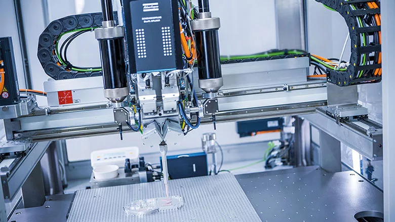

Thermal interface materials require dispensing equipment that can withstand abrasion.

“Due to the high viscosity of the fluids involved, the best approach is process control and mechanical components designed for silicones and abrasive fillers such as alumina, silver and zinc oxide,” claims Gorman. “A mixing tank can be used to maintain fluid uniformity directly feeding the dispenser.
“Filled materials are abrasive, due to the conductive particles suspended in fluid,” says Gorman. “Challenges with getting material break-off from the nozzle require the capability to move the material from a container, and through fluid system components and a dispense valve and nozzle. The dispense mechanism can be a jetting or needle dispensing method, with linear piston pump or progressive cavity valves.”
Jetting material involves a piston contacting a surface opposite an orifice (nozzle). This mechanical interaction causes the piston and the contact surface to abrade more quickly. As such, the dispenser must be capable of generating high forces for closing the piston to achieve break-off of the fluid from the dispense nozzle.
