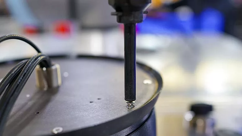

installing screws onto a cover panel of a network antenna
Panorama automated the process of installing screws onto a cover panel of a network antenna.
Photo courtesy Vikaso

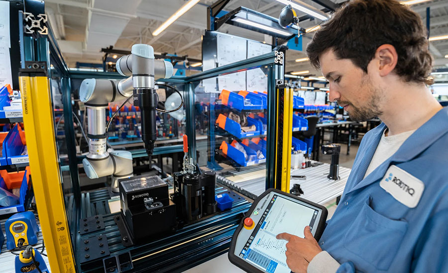

programming the robotic screwdriver
Engineers can program the screwdriver directly with the cobot’s teach pendant. Photo courtesy Robotiq

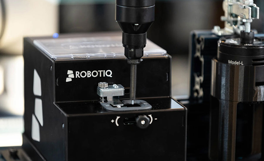

cobot retrieves a fastener from a screw presenter
The cobot retrieves a fastener from a screw presenter. A vacuum bit ensure the screw stays put as the robot travels to a fastening location. Photo courtesy Robotiq

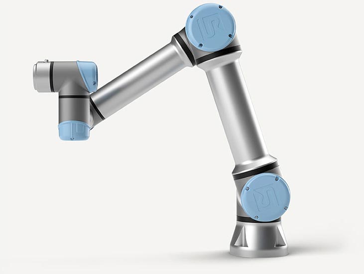

The UR5e is the second smallest model in Universal Robots’ portfolio of six-axis cobots. With a payload capacity of 5 kilograms and a maximum reach of 850 millimeters, the UR5e is ideal for low-weight collaborative processes, such as pick-and-place or screwdriving. The robot’s small footprint makes it easy to integrate into existing production setups.
UR5e collaborative robot
With a payload capacity of 5 kilograms and a maximum reach of 850 millimeters, the UR5e is ideal for low-weight collaborative processes, such as pick-and-place or screwdriving. Photo courtesy Universal Robots

robotic screwdriving
Automating the screwdriving process increased throughput, improved quality, reduced the risk of repetitive stress injuries, and freed up skilled labor to perform other tasks. Photo courtesy Vikaso
