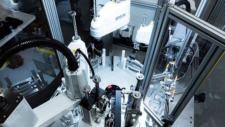

five-station automated assembly system
This five-station automated assembly system produces a heat shield cover every 30 seconds.
Photo courtesy Epson

SCARA robots weld insulating material to a plastic part
Two SCARA robots weld insulating material to a plastic part. A third SCARA unloads the finished assemblies. Photo courtesy Epson

The automated system needed to perform all the operations concurrently. The system would be built around a five-position rotary indexing dial. Parts would be loaded at the first station. At the next station, a pneumatic press would install the compression limiters. The next two stations would ultrasonically weld the insulation material. The final station would automatically unload the assemblies, separating them to “good part” and “bad part” chutes.

The T-Series robots are fast, easy to integrate, and take less time to install than gantry systems. With reach distances of 400 and 600 millimeters, the T-Series can handle payloads of 3 or 6 kilograms. Engineers placed a T6 SCARA robot at each of the two stations to perform ultrasonic welding, and they deployed a T3 SCARA at the final station to unload the finished assemblies.
Initially, AMS engineers planned to use a gantry system to unload the assemblies. However, since they were already using two Epson SCARAs to do the welding, employing a third SCARA to unload the machine made more sense. It saved setup and design time, reduced the overall cost of the machine, and increased reliability.
