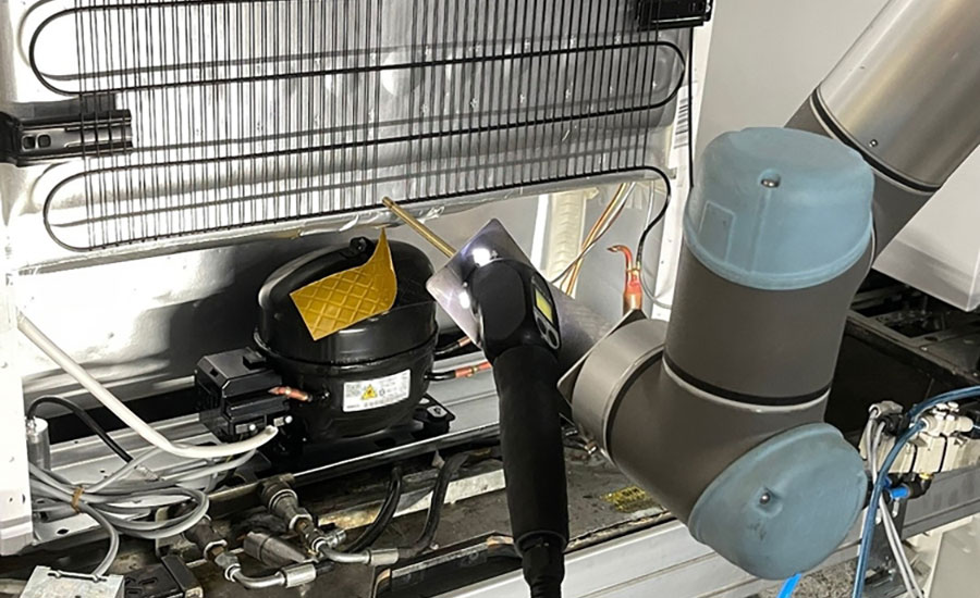

cobot equipped with a sniffer probe
To test the compressor for leaks, engineers equipped a cobot with a sniffer probe. Photo courtesy Mech-Mind Robotics Technologies Co. Ltd.

To test the compressor, engineers equipped a UR5E collaborative robot from Universal Robots with a sniffer probe.

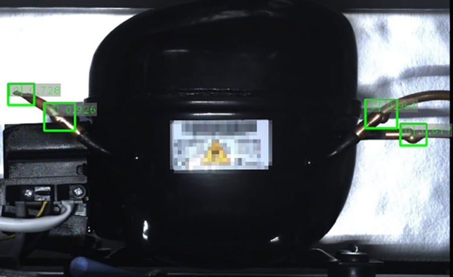

automated part inspection
The vision system accurately recognizes each weld joint, regardless of its position and orientation. Photo courtesy Mech-Mind Robotics Technologies Co. Ltd.

Using structured light technology, the PRO S vision system outputs accurate 3D point cloud data, even for randomly located welding points and compressors with dark surfaces, enabling the robot to precisely locate each welding point.
Each weld joint in the object image can be separately identified. Mech-Vision machine vision software delivers accurate recognition results of each welding point and outputs its exact position for the cobot. Mech-DLK deep learning software trains models rapidly to respond to product and object variations and enable fast changeovers.
Mech-Viz robot programming software plans the optimum path for the robot arm to assess each weld joint without colliding with any part of the compressor or any nearby production equipment.
Mech-Vision filters out the high-pressure weld joint based on the information of the Z-axis and sets a threshold for outputting recognition results. As a result, it can accurately output the location of the low-pressure weld joints. The software gathers data in real-time to manage detection results and review issues, reducing unplanned downtime and improving efficiency.

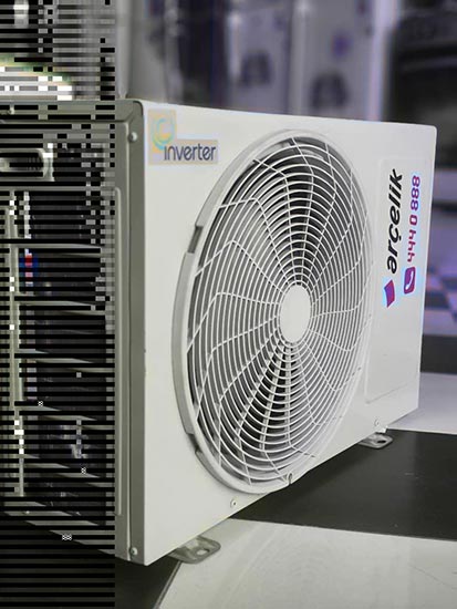

air conditioner
Because air conditioners rely on refrigerant, leak testing is a key part of quality control. Photo courtesy Arçelik

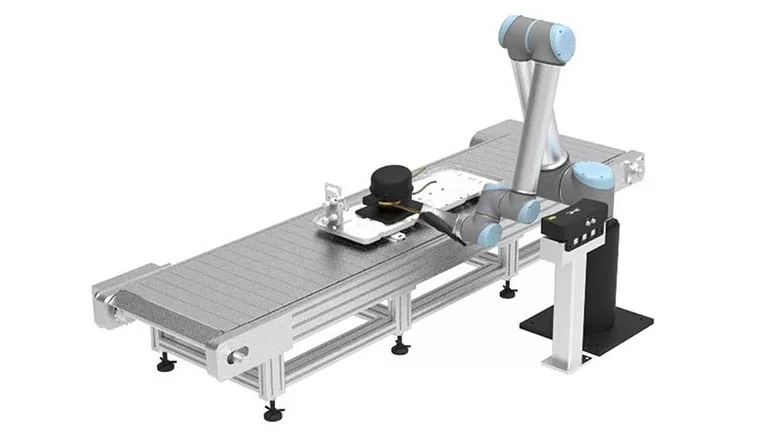

At the factory in Gebze, the Mech-Eye camera is in a fixed position across from the workpiece. It takes images of weld joints and maps the surroundings. Mech-Vision provides the robot with the location of all the weld joints at one time and guides the robot which spot to check first. This ensures that the robot can test all the joints one after another with only one data capture, optimizing efficiency. The software excludes the high-pressure joint and only includes the low-pressure joints.
The vision system identifies the positions of joints based on 3D point clouds. Then it calculates the distances between the welding points and the compressor center to filter out the high-pressure point.
Mech-Viz plans the optimal path for the robot to test each point while avoiding collisions.
If the sniffer probe detects a leak, the system will trigger an alert, and the faulty product will be sent for repair.
