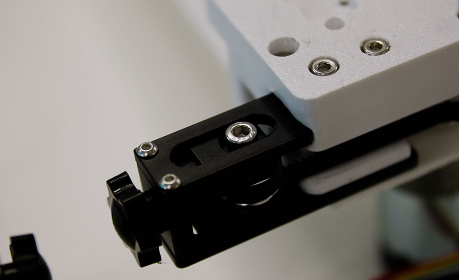

shoulder bolt
Standard shoulder bolts are key part of the Fusion machine. While many designs could have required custom-machined shafts, the ready availability of precision shoulder bolts allowed Kaikaku to swap parts quickly during development. Photo courtesy Accu
captive DIN square nuts
Initially, Kaikaku used brass threaded inserts to fasten certain plastic components. However, these proved difficult to install and lacked torsional strength. By switching to captive DIN square nuts, Kaikaku achieved greater reliability, simpler servicing and faster assembly. Photo courtesy Accu

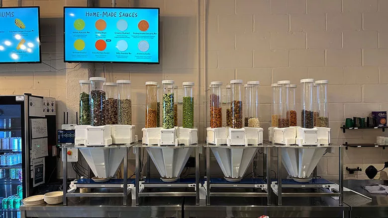

The company’s first product is Fusion, an automated salad bar that combines 3D-printed components, modular hardware and flexible software. An empty bowl enters the system at one end, and a completed salad—made to order according to each customer’s exact specifications—exits at the opposite end. The system can produce 360 servings per hour, allowing staff to focus on hospitality and quality.

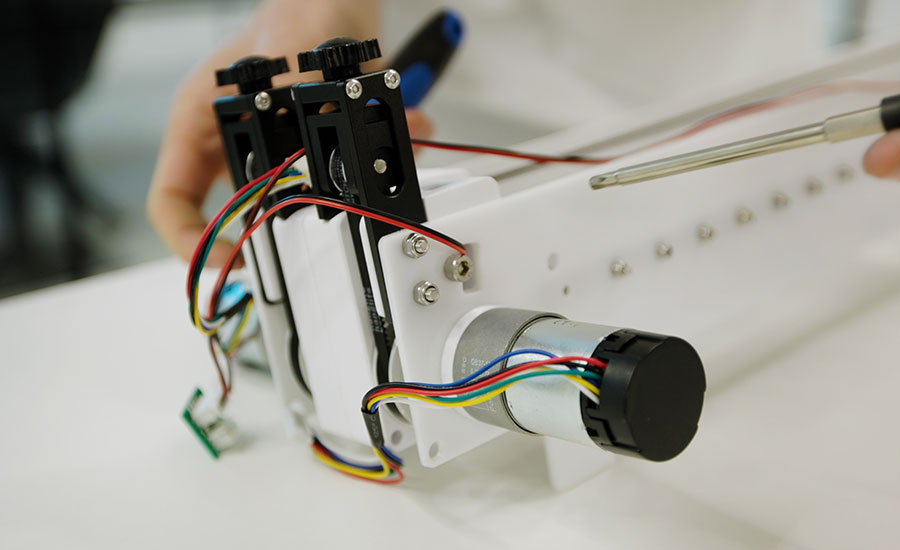

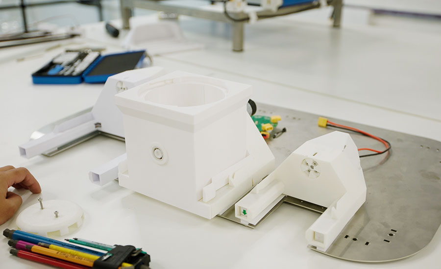

One of the biggest breakthroughs in the Fusion build came from rethinking fastening for 3D-printed components. Initially, the team relied on brass threaded inserts that were installed in the plastic with a heated tool. However, these proved difficult to install and lacked torsional strength. By switching to captive DIN square nuts supplied by Accu, the engineers achieved greater reliability, simpler servicing and faster assembly.

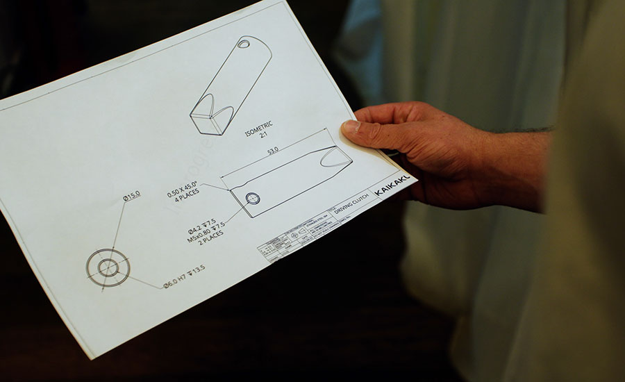

Shoulder bolts, another Accu component, have also become a mainstay. While many designs could have required custom-machined shafts, the ready availability of precision shoulder bolts allowed Kaikaku to swap parts quickly during development, saving weeks of machining time and ensuring that replacement parts could be installed in the field within hours.
