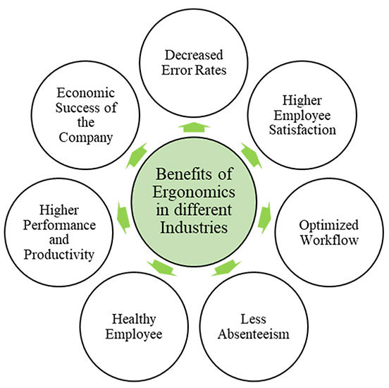

Benefits of Ergonomics in Different Industries
Good ergonomics provides myriad benefits, regardless of industry. Source: University of Johannesburg
