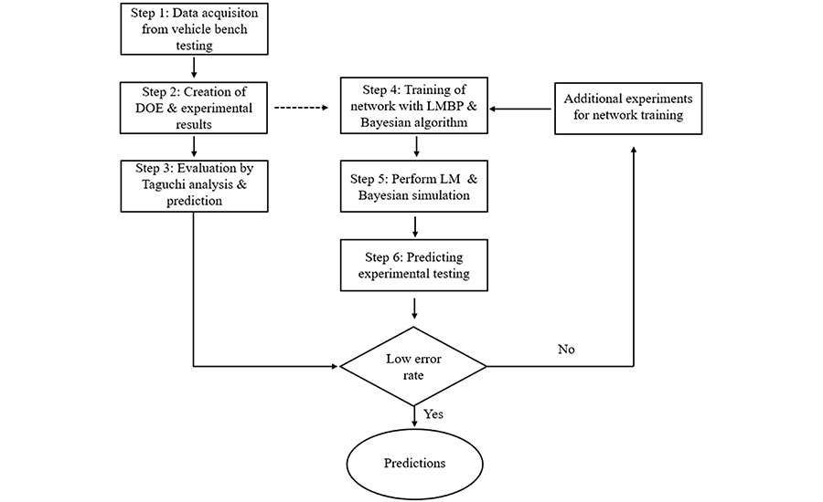

flow chart illustrating development of AI model for joint loosening
This flow chart illustrates how the researchers developed their AI model for joint loosening. Illustration courtesy TOFAŞ Türk Otomobil Fabrikas AŞ
Standardized test methods, such as DIN 65151 and DIN 25201, are effective in terms of performance evaluation for single bolt and nut types. However, the rigid conditions in those tests are not necessarily applicable to bolted joints in automobile chassis. The conditions are different, and the external loads acting on the joints have variable frequency.
Several studies have determined the mechanism of self-loosening of bolted joints, but few studies have used artificial intelligence to predict the behavior of bolted joints. We set out to develop an artificial neural network to predict the mechanism of self-loosening and the behavior of bolted joints on engine suspension connections.
Our approach consisted of three steps. In the first step, we collected external loading values from mechanical testing of engine suspension joints. In the second step, we performed Taguchi method experiments with actual joint conditions to obtain training and test data for the neural network. In the third step, we created a neural network with the Levenberg-Marquardt (LM) and Bayesian Regularization (BR) algorithms to create a relationship between the controlled factors and the loosening rate. We then collected the mean squared error (MSE) values to evaluate the prediction errors of the neural network.
The results show that our approach can be used to predict the mechanism of self-loosening of bolted joints without additional tests, and it is possible to make predictions with very low error rates using AI. This promises to reduce the costs associated with testing new bolted joint designs.
