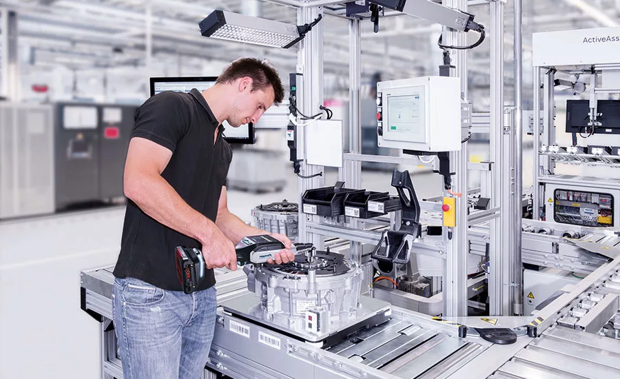

Cordless Nutrunner for Safety-Critical Fastening
The next generation of the NEXO cordless nutrunner has a modern, user-friendly design with significantly improved ergonomics and reliable performance. The browser-based operating system and integrated display provide a clear overview of the current tightening results and reliable connectivity to remote systems. The handheld tool is available as a pistol or right-angle nutrunner and meets the strict requirements of the VDI/VDE 2862 for Category A tightening, which is ideal for safety-critical tightening applications.
The intuitive user interface ensures ease of use. Accessing the tool is simply accomplished via a web browser over Wi-Fi or USB, allowing any connected device such as a laptop, smartphone or tablet to be used for setup, diagnostics and monitoring. With the controller integrated directly onboard the tool, no additional hardware is required for operation, enabling the tool to work independently and flexibly in any production environment.
With decentralized operation and enhanced diagnostic options directly on the large color display, users experience increased engagement at every step of the process. This provides clear worker feedback, contributing to higher uptime and improved ability to troubleshoot production issues directly in the workcell.
The tool is powered by the widely available Bosch ProCORE 18-volt battery. Short charging times and quick battery changes are possible with an innovative keep-alive function to ensure minimal downtime. In addition, multicolor LEDs on the tool body provide visual feedback to the user, even in difficult working positions.
The tool is also equipped with a modern WLAN module for Wi-Fi 6 connectivity and network performance. This allows the tool to remain online during a software update or provide options, such as a manual mode, where the tool can continue to be operated with full functionality even in the event of a network failure.
The tool also features an all-new hardware platform based on a four-core processor, ensuring reliable computing power even for complex applications. A new servomotor delivers maximum performance, with an improved power-to-weight ratio and higher speeds. Maximum flexibility for every application is guaranteed by a modular output system. An accessory interface enables flexible hardware expansion with items such as an external trigger or handling device. The integrated camera-based scanner can also be used to process many new types and sizes of ID codes.
