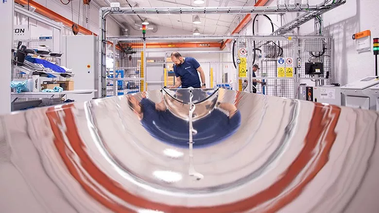

Thermal collectors are troughs that track the sun across the sky to catch its rays. A parabolic reflector focuses the solar irradiation on a receiver, which turns it into heat, which in turn generates steam.

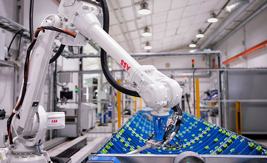

robot applies reflective material to the base of the thermal collector
This robot applies the reflective material to the base of the collector. Photo courtesy Absolicon
Absolicon’s thermal collectors are essentially troughs that track the sun across the sky to catch its rays. A parabolic reflector focuses the solar irradiation on a receiver, which then turns it into heat, which in turn generates steam at up to 160 C. The collectors are the most efficient in their class and are ideal for industrial companies and district heating networks.
Assembling the collectors, which measure 18 feet long and 3.5 feet wide, requires accuracy and repeatability. A pair of six-axis robots from ABB are enabling the company to meet growing demand for its products without compromising on quality.
At Absolicon’s factory in Härnösand, Sweden, the degree of automation has increased production drastically. Where previously Absolicon was able to assemble three collectors per day using manual production methods, the robotic production line can assemble a collector in as little as six minutes.
robot dispenses adhesive to bond the reflective material
This robot dispenses adhesive to bond the reflective material. Photo courtesy Absolicon
