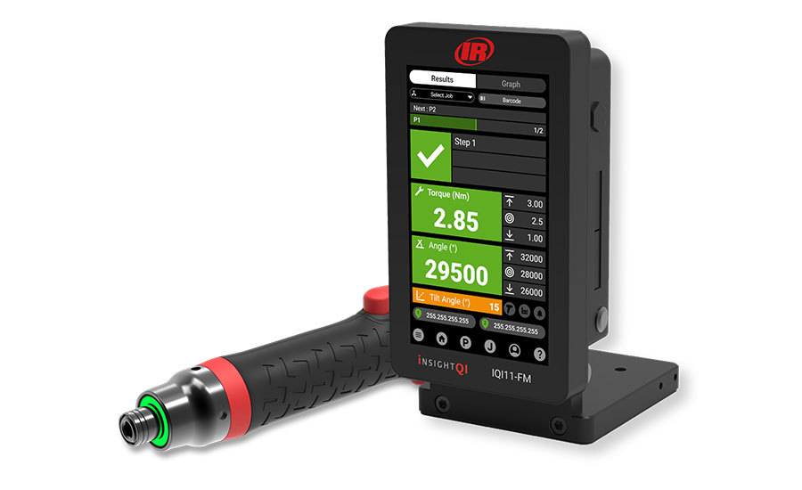

Electric Screwdriver Is Precise
Insight iQi Series electric screwdriver
Photo courtesy of Ingersoll Rand.
The Insight iQi Series electric screwdriver is for low-torque precision fastening applications. With state-of-the-art torque and angle control strategies, real-time monitoring and seamless integration with manufacturing execution systems or Fieldbus networks, this tool optimizes assembly lines by eliminating errors, reducing downtime and boosting productivity. Its easy-to-use interface and fully remote setup capabilities streamline the programming process, cutting setup time by 50 percent and reducing operational disruptions.
The tool introduces an industry-first: tilt angle control, which ensures optimal tool alignment throughout the assembly process. By actively preventing cross-threading and maintaining joint integrity, this feature significantly reduces rework and minimizes the risk of defects. The system continuously provides real-time feedback, allowing assemblers to fine-tune their approach and enhance fastening quality at every step.
A user-friendly 7-inch touch screen enables quick system configuration and seamless job setup. The tool’s 100 percent remote accessibility empowers engineers to set up, program and troubleshoot from anywhere, eliminating the need for on-site adjustments and minimizing workflow interruptions. Integrated MES and Fieldbus support ensures automated tool and job selection, reducing manual setup errors.
The tool achieves a fastening accuracy of ±3.5 percent for transducerized models and ±10 percent for current-control models. Through live monitoring and traceability, the system continuously tracks torque, angle and seat control strategies, allowing for real-time issue detection and correction. The tool is engineered to withstand more than 1 million maintenance-free cycles.
Its ergonomic grip enhances user comfort, reducing fatigue and increasing productivity. The 360-degree LED status beam provides instant feedback, ensuring that each fastening is achieved correctly. Live Trace Technology enables real-time torque curve analysis. With the ability to store up to 1 million fastening records, manufacturers gain complete traceability, ensuring compliance with stringent quality standards.

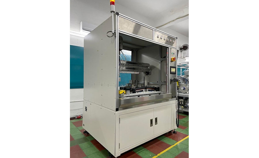

Semiautomatic Screwdriving Cell Is Fast, Accurate
semiautomatic screwdriving cell
Photo courtesy of Ito America Corp.
This semiautomatic screwdriving cell has a gantry positioning system that is accurate to ±10 microns. It can be equipped with a tilting stage and either one or two fastening spindles. It can install screws at a rate of one every 3.5 seconds. The work area measures 300 by 300 millimeters. Fasteners can be supplied with a screw presenter or they can be blow-fed directly to the driver. The machine can install fastener sizes M2 to M5.

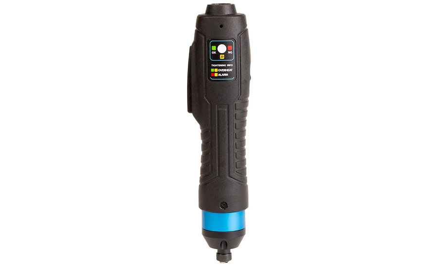

Electric Screwdriver Is Smart
Mini MDT all-in-one smart electric screwdriver
Photo courtesy of Mountz Inc.
The Mini MDT is an all-in-one smart electric screwdriver for micro torque fastening applications. The screwdriver safeguards against fastening failures. The error-proofing system reduces defects. Engineers can easily program the controller with fastening workflows and torque tolerances for each fastener in the sequence. The tool records and stores torque and fastening data. A single DC control system replaces up to 15 power tools. The tool includes free product software; no annual licensing is required.
The tool works with a variety of optional equipment. For example, the controller can be connected to a smart bit and socket tray. The tool won’t function unless the correct bit or socket has been selected. Selecting a bit or socket automatically updates the torque and angle settings on the tool for the specific application.
Equipped with position encoders, the position-control torque arm helps to ensure that fasteners are installed in the correct locations in the correct sequence. A screw presenter delivers up to two screws per second to a fixed point where a worker or a robot picks them up. Engineers can magnetize a bit by sliding a Mag-O-Net onto it. This accessory is commonly used with a screw presenter.

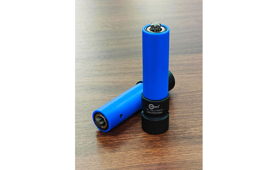

Torx Impact Sockets Designed for Toyota Vehicles
Torx impact sockets
Photo courtesy of Normeco USA.
Torx impact sockets have been specifically designed to tighten fasteners on Toyota vehicles. The sockets have been engineered to fit Toyota fasteners precisely, ensuring accurate torque transfer. A magnetic ring around the Torx bit ensures the sockets can easily catch the Torx screws. The sockets are made from high-strength alloy steel to withstand extreme impact forces. A protective cover on the sockets enhances safety.
The sockets are divided into two parts, allowing worn-out Torx bits to be replaced. Toyota production line engineers often found that Torx tips are prone to breakage. Normeco engineers developed these sockets to address that issue.

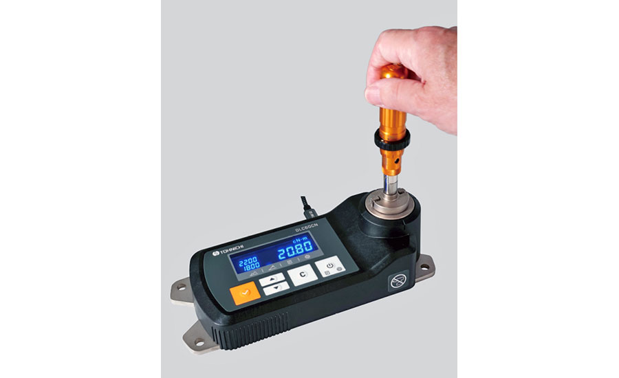

Instrument Tests Torque Screwdrivers
DLC-G Driver Line Checker
Photo courtesy of Tohnichi America.
The DLC-G Driver Line Checker is used to verify the accuracy of manual torque screwdrivers. Designed specifically for assembly line applications, the device delivers rapid and precise torque verification in just seconds. Its user-friendly, color-coded pass-fail system makes quality control effortless—blue indicates a pass, while red signals a fail.
Two models are available to accommodate a wide range of applications. DLC60CN-G handles a torque range of 2 to 60 newton-centimeters. DLC600N-G handles a torque range of 20 to 600 newton-centimeters. Both are accurate to ±1 percent of the indicated value +1 digit, making them ideal for verifying click-style torque drivers. The instrument supports multiple measurement units, including newton-centimeters, kilogram-centimeters, and inch-pounds.
