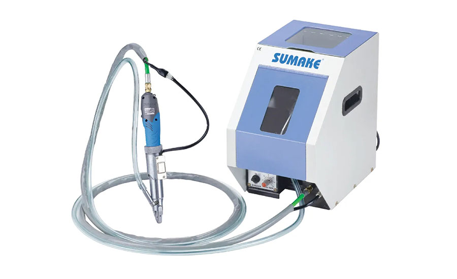

SF30A Screw Feeder from Sumake
Photo: Sumake North America
Screw Feeder System
The SF30A Screw Feeder is an automated system engineered to feed screws and present them directly to the screwdriver tip. Screws are delivered through a distribution tube to the jaw for immediate installation, supporting reduced cycle times and improved production efficiency.
The system accommodates fasteners from M2.5 to M6. The driver can install approximately 20 to 30 screws per minute, and the hopper holds up to 2,000 M3x15 screws. The driver may be suspended from a balancer, mounted in a torque-reaction arm or to a cobot.
Each SF30A system is customized for the user’s specific fastener and application requirements and is delivered fully assembled.
See this company at The Manufacturing & Automation eXchange March 24-26 in Nashville.
https://sumakenorthamerica.com
