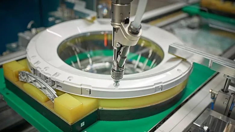

Recently, an appliance manufacturer in Poland wanted to increase throughput and quality on the line that assembles doors for washing machines. Specifically, the process of installing screws to secure a glass window in the door had become a bottleneck. Engineers wanted to automate the process.

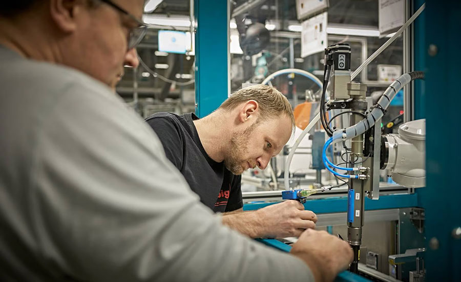

Automating the screwdriving process freed up skilled labor to perform other tasks. Photo courtesy Kuka

It was then that Qbig engineers came up with a unique way to shave a few seconds off the cycle time: screwdriving “on the fly.” The door would still stop at the station, at least initially. However, as the last fastener is being driven, the door begins moving out of the station, freeing up space and allowing the next door to enter, stop and position itself, so the robot can begin installing screws immediately, without having to wait.

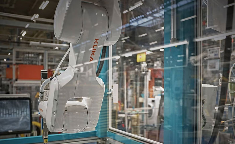

For a conveyor-tracking application, a six-axis robot was the best option. Photo courtesy Kuka
For this design, a six-axis robot was the best option. Qbig engineers chose the KR Agilus robot from Kuka to do the job. The KR Agilus is a compact six-axis robot for particularly high working speeds. Maximum payload ranges from 6 to 11 kilograms, and maximum reach ranges from 706 to 1,101 millimeters. Positional repeatability ranges from ±0.02 to ±0.03 millimeter.
The robot can be mounted to the floor, ceiling or wall. It is ideal for confined spaces thanks to its integrated energy supply and control technology. Safe robot functionality enables innovative automation concepts. The robot is protected against electrostatic discharge, and variants are available for clean rooms; hygienic or wet environments; and potentially explosive environments.
Thanks to its lifetime lubrication, the robot never needs a change of lubricant in the gear units and has minimal maintenance requirements.
For screwdriving on the fly to work, Qbig engineers needed a way to precisely determine and control the position of the moving components to ensure the fastener is installed correctly. Kuka’s ConveyorTech software solved that problem. The software coordinates interaction between the robot and conveyor. The software automatically adjusts the robot’s movements to the linear motion of the assembly line.
