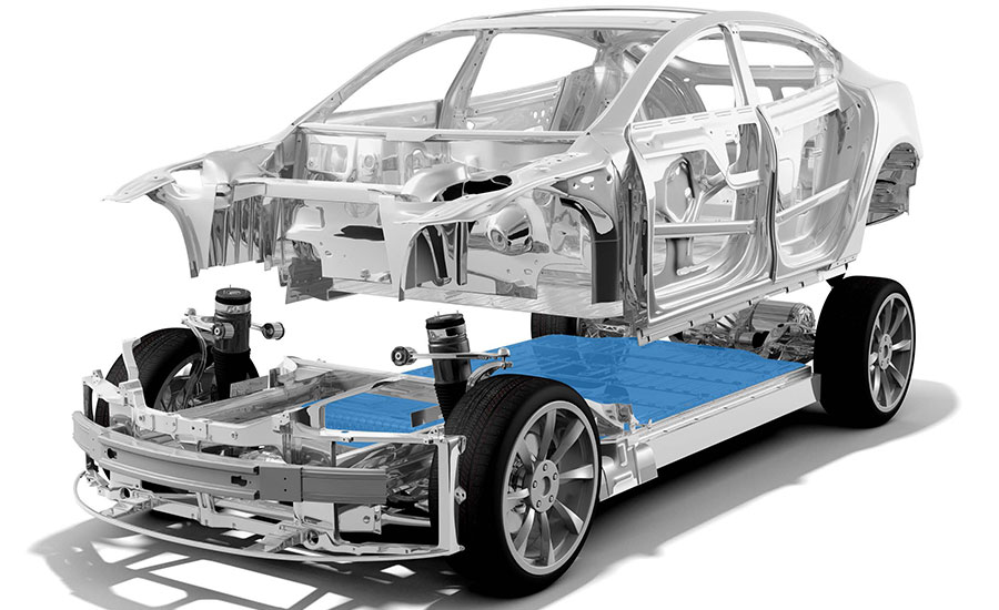

electric vehicle (EV)
Aluminum is emerging as a compelling alternative for conducting electricity in EVs. Photo courtesy PennEngineering
