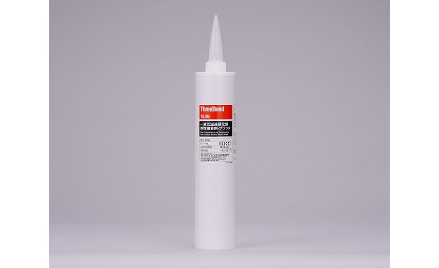

ThreeBond 1539 urethane adhesive
Image courtesy of Threebond International
Flexible Urethane Produced From Plant-Based Materials
ThreeBond 1539 is a one-component, fast-curing elastic urethane adhesive for bonding, sealing and potting various materials. The adhesive can be cured by heating at a relatively low temperature (60 C) for a short time and does not require a long-time curing process. It uses a plant-derived polymer as the main component. The cured material is an elastic body, which is resistant to vibration and impact and excels in relaxation of stress caused by expansion and contraction of parts. It is elastic over a wide temperature range (-35 to 100 C).
It has excellent adhesion to various materials, including aluminum, steel, stainless steel, copper, phenolic resin, epoxy, acryl, ABS, polycarbonate, nylon, PET, PBT, PPS, PVC and glass.
