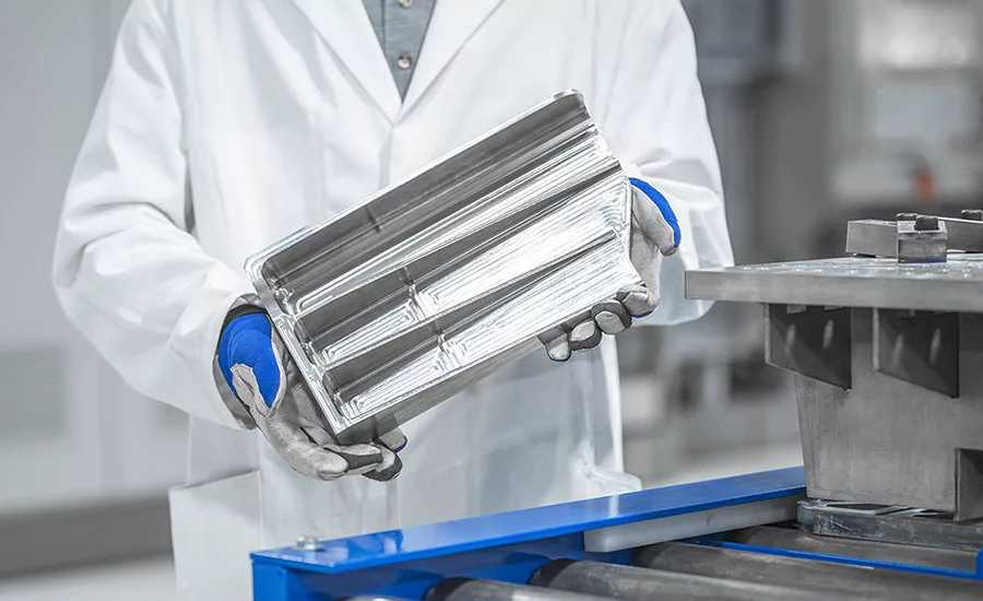

Titanium has the highest strength to weight ratio of any metal.
Photo courtesy Norsk Titanium

Titanium has the highest strength-to-weight ratio of any metal. It’s used to make everything from golf clubs to rocket engines and brake calipers to orthopedic implants. However, the lightweight metal has traditionally required an expensive, slow and resource-intensive manufacturing process.

“Producing Ti64 parts often requires significant material removal from a billet, resulting in a high buy-to-fly ratio, meaning much of the raw material is wasted and not used in the final product,” explains Storck. “While additive manufacturing provides a promising alternative to reduce material waste and the associated costs, it can be slower. [Our] recent work demonstrates one method to reduce the production time for near-net-shape-parts, making the process more efficient.”
