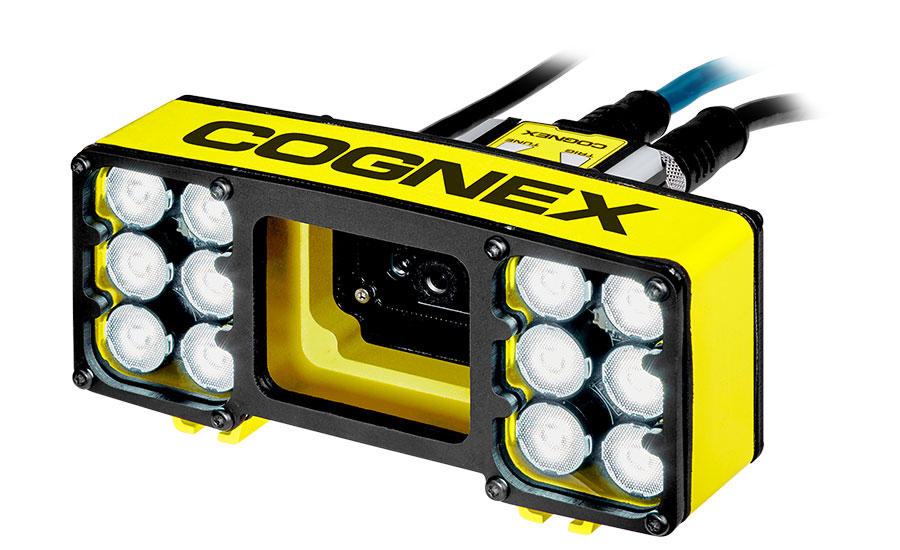

In BorgWarner’s EV power train assembly application, the production technology team had to detect missing parts on a flat surface. Some machine vision systems couldn’t detect defects because of the low contrast of the image, even when the systems were repositioned or looking at a different portion of the power train. A 3D vision system solved this problem.
With 2D machine vision, a two-dimensional map of reflected intensity is captured and processed. Processing consists of comparing variations in intensity or contrast. For this reason, 2D vision systems need highly controlled environments with standard viewpoints and lighting that creates high contrast and eliminates shadows. These systems are typically used for applications like defect detection, optical character recognition, and assembly verification.
3D machine vision captures the depth of a target object to generate a three-dimensional map, or point cloud, for analysis. The point cloud offers precise coordinates where the position of every pixel in space is known. This makes 3D vision useful for tasks where shape information is critical. 3D machine vision works well with objects that can vary in size and shape.
“The Cognex 3D vision system detected everything and found the defective parts,” says Park. “It lets you see all the geometric data, so when the customer comes to visit, we can show them we’re using 3D vision systems for geometry inspections; they’re happy, and we’re happy.”

The Park-Lock system is largely put together manually. Among other tasks, assemblers tighten bolts and assemble parts. BorgWarner uses the Cognex In-Sight 2800 machine vision system with edge learning—an easy-to-use artificial intelligence technology—to verify that all Park-Lock components are installed correctly.
“There are springs. There are thin nuts. There are many [potential] assembly mistakes,” Park says. “When you put a bolt into a thin, flat part, it’s hard to tell if it’s flush and meets the required tolerance with most vision systems. But since we’ve had the In-Sight 2800, we’ve been able to catch all of these defects, and it’s solved 100 percent of our problems.”

The In-Sight 2800 vision system combines AI with traditional rule-based vision tools to solve a wide range of applications, including presence-absence detection, sortation and character reading.
The edge-learning classifier tool identifies and sorts parts based on multiple features or characteristics. This enables engineers to classify defects into different categories and correctly identify parts with variation. Along with the ability to assign multiple classifications, engineers can set up multiple regions of interest to inspect different sections of an image with a single trigger.
The technology is easy to use. Cognex’s EasyBuilder development environment simplifies setup. No programming experience needed. The intuitive development environment walks engineers step-by-step through application setup, enabling rapid turnaround from proof of concept to deployment. A robust spreadsheet interface is well-suited for building advanced or highly customized applications. It allows engineers to fine-tune application parameters.
High dynamic range technology uses advanced image sensing that is 16 times more detailed than conventional sensors. This drastically increases image quality and contrast, resulting in more accurate inspections and detection of subtle defects.
With field-changeable components, the In-Sight 2800 can be modified to address various application settings and custom requirements. This modularity allows manufacturers to quickly adapt to new parts and keep up with changing demands.
