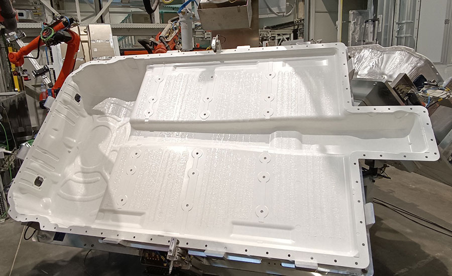

automated line assembles EV battery enclosures
This automated line assembles EV battery enclosures made of aluminum, SMC and mica. Photo courtesy Robatech Group

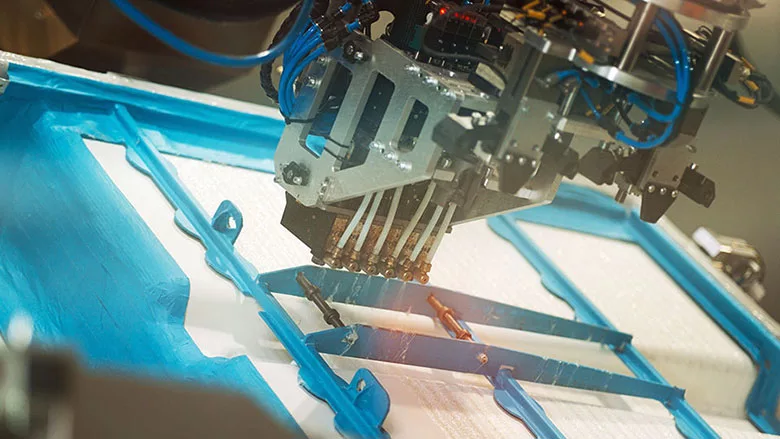

The enclosure parts can be optimally bonded by spraying the hot-melt adhesive in a swirl pattern. Two factors are important. First, the swirls should be applied evenly in a row. This requires precise positioning and repeat accuracy. Second, the rows of swirls should be as close together as possible without overlapping. This requires precise edge accuracy of the swirl application. If both factors are met, there will be no unevenness on the surface of the parts, and the bond will be reliable.

In August 2023 and January 2024, JHV installed the second and third production lines, each with identical workstations, in Milovice. At the first station, two six-robots from Kuka, equipped with Aero spray heads from Robatech, apply the hot-melt adhesive in a swirl pattern inside a deep-drawn aluminum sheet. An SMC laminate is then bonded to the aluminum. Previously, an application head with five spray elements was used for this application. Robatech uses six elements to reduce the time required for adhesive application.
Each spray element can be controlled individually. A single spray element is sufficient for applying adhesive to the edge of the sheet. For the flat part, elements are switched on or off as required during the movement of the robot. Although the adhesive is omitted in certain areas, the application quality remains stable throughout the dispensing process.
“The ability to control individual spray elements in real time has enabled us to achieve very high precision in adhesive application on complex, three-dimensional surfaces,” says Petr Jakube, project manager at JHV. “The previous supplier could not offer this flexibility.”
