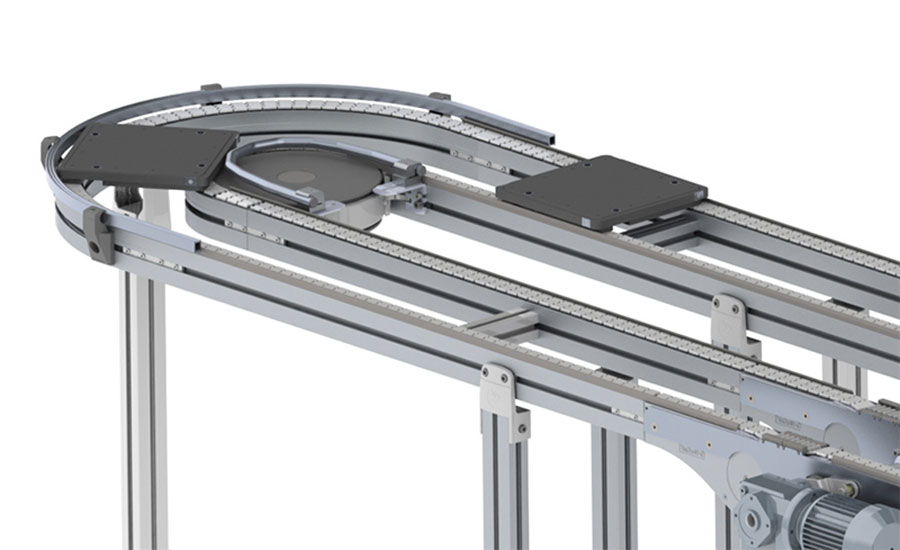

Twin-Track Pallet Transfer Conveyor
XT twin-track pallet transfer conveyor
Image courtesy FlexLink Systems Inc.
The XT twin-track pallet transfer conveyors move individual assemblies on pallets. Pallets travel on flexible plastic chains. The standard pallet widths are 240 by 240 millimeters or 640 by 640 millimeters. The weight of the conveyed assemblies can vary from a few grams up to 30 kilograms. Configurable standard modules make it easy and fast to create advanced and straightforward layouts for routing, balancing, buffering and positioning pallets. RFID tags on the pallets enable engineers to track, trace and control production on the line. The conveyor can be used for both manual and automated assembly lines. For pallet handling, we offer a wide range of conveyor components. Accessories are available for stopping, locating, lifting, rotating and supporting pallets.
www.flexlink.com
Booth 621

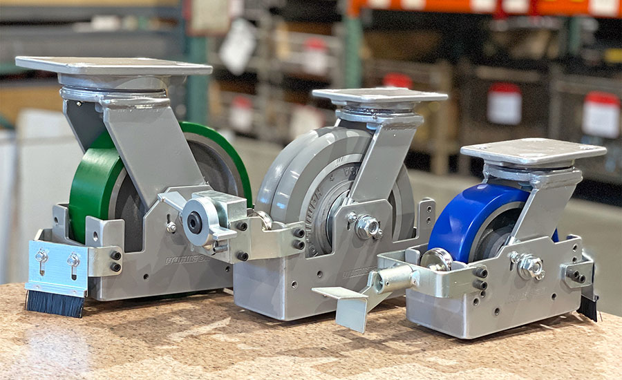

Guard Protects Feet From Being Injured by Carts
Field-Installable Toe Guard
Image courtesy Hamilton Caster & Manufacturing Co.
The Field-Installable Toe Guard protects feet from being injured by carts. The guard supports two brake styles—heavy-duty contact brakes and ergonomic brakes—as well as optional floor brushes. All components are field-installable. Heavy-duty contact brakes ensure steady support for larger loads, while ergonomic brakes reduce operator strain and fatigue. Optional floor brushes sweep away debris and foreign objects during operation, protecting casters from damage and keeping pathways clear.
Constructed from 3/16-inch steel and finished in a sleek platinum gray, the toe guard is built for durability. It installs with an industry-standard ½-inch floor clearance—no drilling or modifications required—and is available for wheel sizes of 4 to 12 inches. The guard can be ordered pre-assembled on new casters, or it can be ordered separately for retrofitting.
www.hamiltoncaster.com
Booth 342

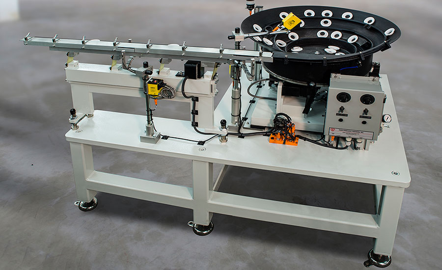

Advanced Capabilities for Custom Parts Feeding
custom parts feeding
Image courtesy Performance Feeders Inc.
Performance Feeders Inc. designs and manufactures part feeding equipment for packaging and assembly operations. Utilizing in-house advanced resources and capabilities, with solid modeling and CAM software, a complete CNC machinery operation, 3D printed prototypes, and robotics, the company manufactures repeatable custom automation equipment to feed medical, pharmaceutical, packaging, automotive, electronic and industrial products.
The company’s extensive line of products includes vibratory bowl feeders, centrifugal feeders, step feeders, drum feeders, flex feeders, conveyors, unscramblers, spring feeders, prefeeders, elevators, protective enclosures, visual inspection, and part isolation with custom control packages.
https://performancefeeders.com
Booth 439

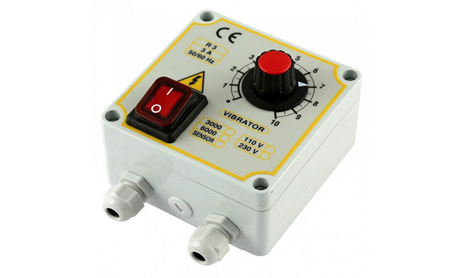

Controller for Vibratory Feeders
R3FC phase angle controller for vibratory feeders
Image courtesy MP Elettronica Italy
The R3FC is a compact and easy-to-use phase angle controller for vibratory bowl feeders and vibratory linear feeders. The maximum current is 3 amps. Input voltage can be 115 or 230 volts. Vibration frequency can range from 50 to 100 hertz or 60 to 120 hertz. The controller can be equipped with a NPN/PNP sensor. It is also available in an opto-isolated version. A soft start can be programmed from 0.2 to 2 seconds. Enclosures are available to meet protection ratings of IP00, IP55 or IP65.
www.mpelettronica.com
Booth 1501

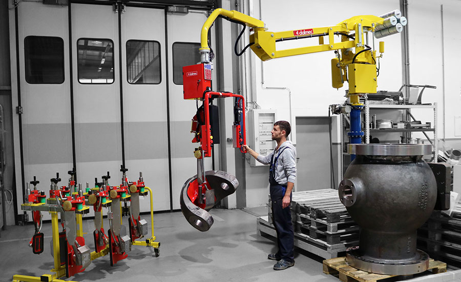

Manipulator Moves Heavy Loads
Partner Equo pneumatic manipulator
Image courtesy Dalmec Inc.
Partner Equo is a column-mounted pneumatic manipulator with articulated arms that enables workers to lift, move and position heavy loads. The manipulator can be equipped with vacuum cups and other tooling to grip a variety of objects. Its modular structure has been designed to resist the torsion resulting from moving heavy loads. A pneumatic cylinder, combined with a transmission lever system, provides balance to the load. The force of the cylinder is controlled by two specially arranged pneumatic circuits: The first keeps the weight of the gripping system always balanced; the second keeps the weight of the load always balanced.
The manipulator can rotate 360 degrees on the column and tooling axis, and 300 degrees on the intermediate axis. It can lift a maximum load of 500 kilograms. It has a maximum working radius of 4,000 millimeters and a vertical lift of 2,450 millimeters. Maximum vertical lifting speed is 0.5 meter per second.
Dalmec Inc.
www.dalmec.com
Booth 1037
