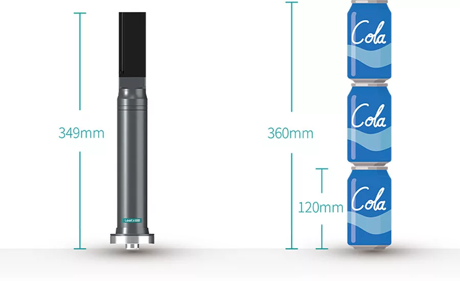

Small and lightweight, the PLP precision servo press is ideal for integrating with robots.

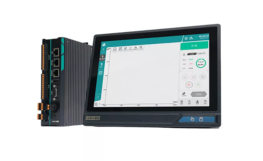

The control system for the servo press gives engineers precise control of force, displacement and ram speed.

A small, lightweight model, the PLP precision servo press, is ideal for integrating with robots. It can control force to within 0.5 percent of the set value and is suitable for micro-force press-fitting applications. The same height as three cans of soda, the press comes in two versions: one with a maximum force of 200 newtons and a maximum stroke of 100 millimeters, and the other with a maximum force of 500 newtons and a maximum stroke of 200 millimeters. Maximum ram speed is 200 millimeters per second.
