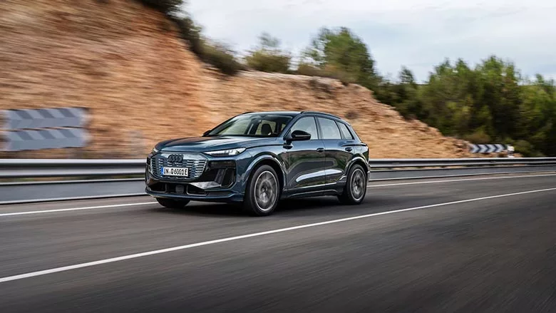

Audi Q6 e-tron
Photo courtesy Audi
The Audi Q6 e-tron can accelerate from 0 to 60 mph in 5 seconds.

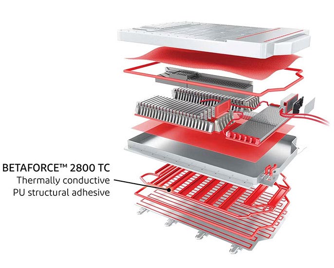

Betaforce 2800 TC structural adhesive
DuPont worked with Audi to formulate a version of Betaforce 2800 TC that would conduct heat away from the battery during charging and driving. Photo courtesy DuPont
For Audi, that adhesive was Betaforce 2800 TC from DuPont. This two-component urethane adhesive bonds composites and metals in a variety of lightweight designs. It can be used to bond dissimilar materials, including steel to aluminum, carbon-fiber composites to steel or aluminum, and sheet molding compound to aluminum.
With a mix ratio of 1-to-1, the adhesive can be dispensed from bulk containers with standard meter-mix equipment. Formulations vary based on the specific vehicle and production process, reflecting variables such as viscosity, application temperature, conductivity, cure time, strength, temperature, and modulus of elasticity.
DuPont chemists worked with Audi engineers to formulate a version of Betaforce 2800 TC that would conduct heat away from the battery during charging and driving. The material’s combination of high elasticity and elongation helps ensure that the battery pack and the bonded substrates that support it will last over the vehicle’s lifetime.

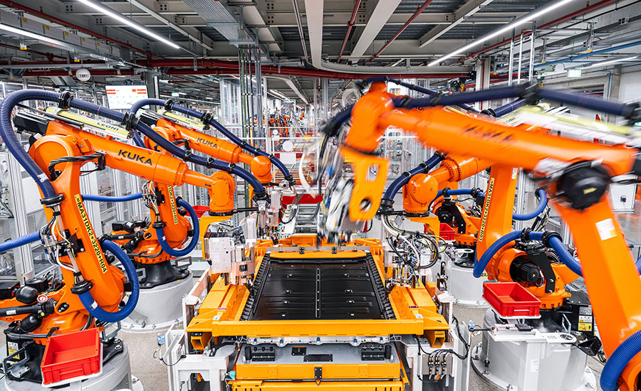

The good shear thinning behavior of Betaforce 2800 TC allows for fast dispensing to support high-volume production. Testing confirmed that the adhesive’s properties meet or exceed Audi’s requirements for heat curing, mixer dwell times, pump pressures, and press-in forces.
The good shear thinning behavior of Betaforce 2800 TC allows for fast dispensing to support high-volume production. Photo courtesy Audi
Using an adhesive to assemble the battery pack brought design benefits, as well. The weather-resistant adhesive enabled Audi engineers to locate the battery back assembly in the floor of the passenger compartment, creating a low center of gravity for dynamic handling.
Recent formulations of Betaforce offer a cycle time of around one minute and are being used in a variety of mass-production applications, including Audi. Open times can be adjusted to accommodate specific mounting requirements on the assembly line, such as a faster curing time with infrared treatment. The initial adhesion requires no additional fixing tools.
