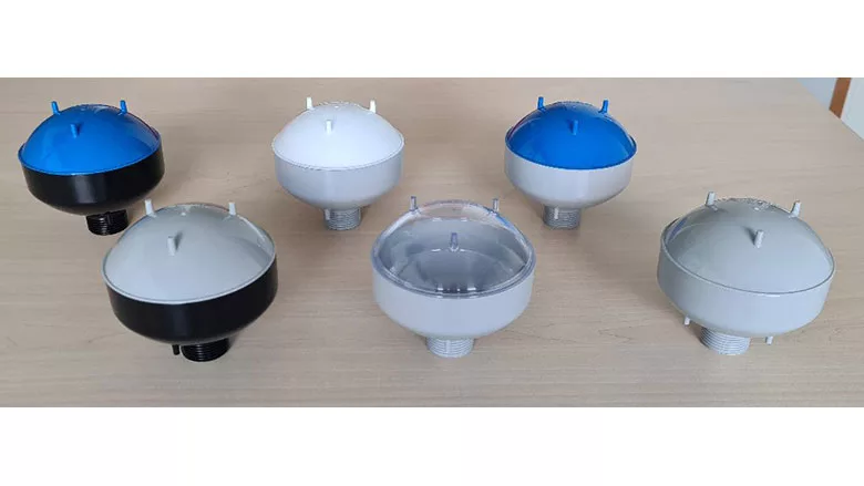

multicolor plastic medical devices
Photo courtesy SABIC Polymers
Laser welding is ideal for joining multicolor plastic medical devices. Photo courtesy SABIC Polymers

Through-transmission laser welding (TTLW) involves passing laser energy through two plastic layers. One layer is transparent to the laser beam’s specific wavelength, while the other absorbs the laser energy and causes melting. The two polymers being joined should be compatible, but do not have to be the same type of resin.
In the TTLW process, a controlled amount of laser energy is delivered to a precise location to heat the absorbent plastic layer, causing it to melt. Because the heat generated by the laser is carefully confined, laser welding helps protect temperature-sensitive parts.
Most TTLW processes today use laser wavelengths around 1 micron. However, lasers operating at higher wavelengths up to 2 microns are available, which enables engineers to weld transparent parts.
The heat from the molten absorbent layer is conducted to the transmission layer through direct contact. Melting and intermingling of the two layers create a strong bond between them.
Clamping is required to conduct heat and to ensure a firm, gap-free weld at the interface. Key parameters for achieving a strong weld are the type of near-infrared laser and its power, as well as welding speed and clamping pressure.
Because most resins are inherently transparent to laser energy, absorption must be optimized by incorporating pigments and fillers, such as carbon black, in the plastic. These additives typically yield darker colors.

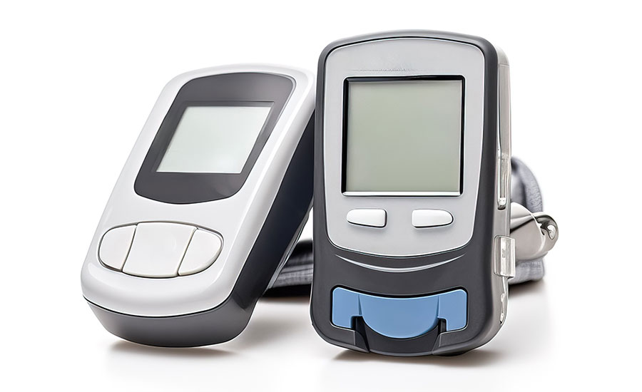

Insulin pump and continuous glucose monitoring devices
Insulin pump and continuous glucose monitoring devices are assembled with laser welding. Photo courtesy SABIC Polymers

When hermetic sealing is required, such as in wearable medical devices like continuous glucose monitors, laser welding technology can produce strong welds. These seals provide a complete barrier against water, dust and oxygen ingress, for example, permitting patients with a wearable device to shower and swim.
