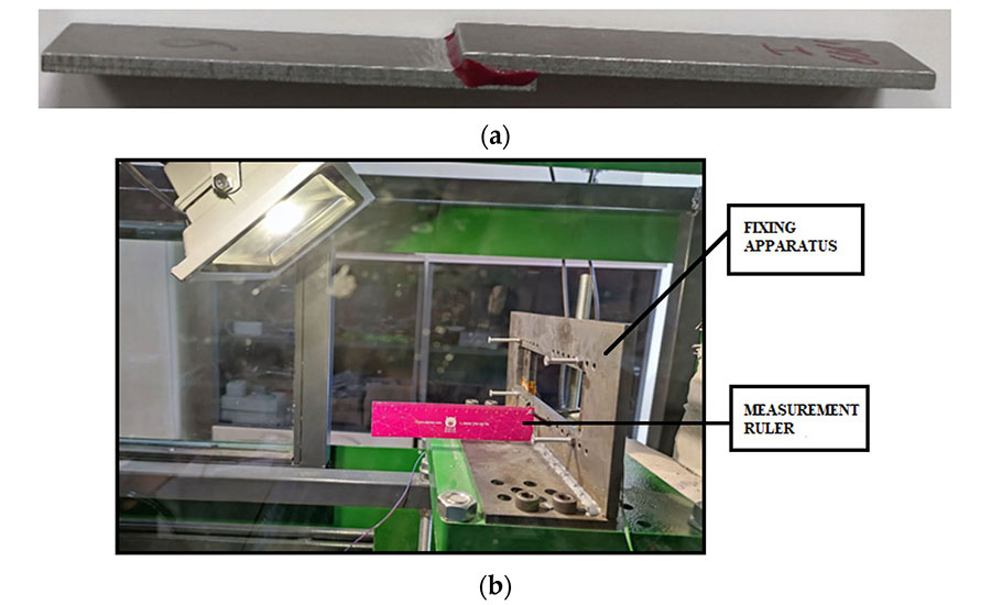

bonded test coupons (a) and the apparatus (b) in which the specimens are fixed before the test
These images show the bonded test coupons (a) and the apparatus (b) in which the specimens are fixed before the test. Source: Ankara Yildirim Beyazit University

The SLJs were made from 6061 aluminum alloy bonded with a modified epoxy film adhesive. The coupons were sanded and cleaned prior to bonding. The bonding process was conducted in a digitally controlled oven at 125 C under a pressure of 2 bars for one hour, in line with the manufacturer’s guidelines.
The test setup consisted of a pressurized air gun, a high-speed imaging system, data acquisition equipment, and a custom clamping fixture to securely hold the test specimens. Measuring 5.5 millimeters in diameter, the projectiles were round-nosed lead pellets, each weighing 1.25 grams. The distance from the projectile to the target was 210 centimeters.
After impact, the joints were subjected to quasi-static tensile loading using a universal testing machine with a maximum load capacity of 100 kilonewtons. To assess the extent of performance degradation, the results obtained from the impacted joints were compared to those from pristine, unimpacted specimens.
