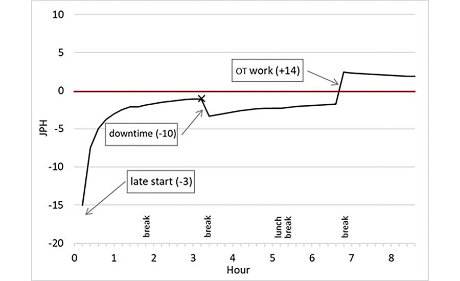

Throughput rate—often expressed as jobs per hour (JPH) or units per time unit—captures real-time variation. Unlike cumulative counts, rate tracking reveals performance fluctuations during a shift.
Figure 1 illustrates an example of a throughput rate deviation chart over a shift. In the example, three events are evident: a late start (-3 units), a breakdown (-10 units), and overtime recovery (+14 units). Overall, the shift achieved its target; however, it did so at the expense of significant overtime costs.
graph of throughput rate
Throughput rate—often expressed as jobs per hour (JPH)—captures real-time variation in production. In this example, three events are evident: a late start (-3 units), a breakdown (-10 units), and overtime recovery (+14 units). Photo courtesy Eastern Michigan University
Action: Use production counts for overall results and JPH deviation charts for performance diagnostics. When inline inspection is available, exclude defective units from both metrics.
