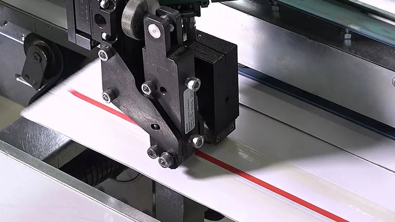

Vivo 18 nozzle
Photo courtesy Robatech
The Vivo 18 nozzle can dispense bead widths ranging from 2 to 18 millimeters.

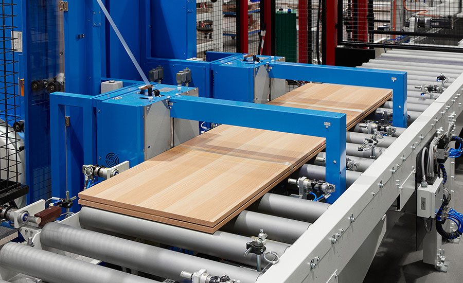

To automate assembly of a new product, IKEA turned to German company Lehbrink, which specializes in automated woodworking equipment, and Swiss company Robatech, which specializes in automated dispensing technology. Photo courtesy Robatech

Lehbrink developed a continuous-flow production system specifically for the Pax 2.0 product. The system aligns the side panels and back panel with millimeter precision—the biggest challenge of the project. Everything else is a sequence of proven processes: cutting to the correct width, bonding and cooling.
The system aligns the side panels and back panel with millimeter precision. Photo courtesy Robatech

The highlight of the dispensing system is Robatech’s Vivo 18 flat nozzle. Robatech adapted the nozzle’s geometry specifically for this application to ensure precise and even application of the adhesive.
Designed for high-speed dispensing applications, the nozzle can apply hot-melt adhesive at a rate of 250 meters per minute. It can accommodate viscosities ranging from 100 to 10,000 millipascals. Bead width ranges from 2 to 18 millimeters.
Due to the vertical distribution in the nozzle, the Vivo 18 applies the specified coating weight precisely and uniformly from start to finish and achieves exact edge definition. The negative-closing injection element and the ability to precisely adjust the nozzle’s orientation relative to the substrate ensure clean removal.
Thanks to its compact design, two heads can be mounted in parallel for greater flexibility in installation and production.
Initial tests with the standard Vivo 18 nozzle were precise, but not optimal. The nozzle lacked the necessary tolerance to compensate for the rough surface of the particleboard. Working closely together, Robatech and Lehbrink revised the nozzle geometry several times.
