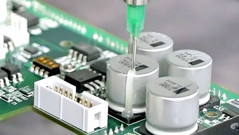

Adhesives with low ionic contamination maintain electrical insulation integrity and prevent corrosion-related failure, ensuring long-term reliability.
June 2, 2026
Adhesive bonding is a popular assembly process because it enables engineers to create strong joints. But industrial adhesives have several drawbacks, such as outgassing, which can cause problems in some applications.
When a material is exposed to a vacuum or low-pressure condition, adhesives can release gases, which can contaminate surroundings or interfere with sensitive equipment.
This particularly affects aerospace applications and products that rely on optical components, optoelectronics or photonic systems. Semiconductors and medical imaging devices, such as endoscopes, are also prone to problems.
Outgassed substances can corrode and degrade delicate electronic components. They can also cloud lenses and create performance issues.

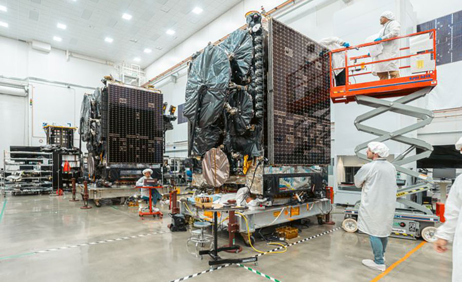

Out-of-This-World Problems
Outgassing poses significant headaches to spacecraft engineers, since satellites and other devices are subjected to extreme temperature fluctuations due to the sun’s unfiltered radiation. The issue is exacerbated by the fact that a craft’s colder surfaces typically include crucial components such as cameras, lenses, mirrors and sensors.
“If a substance gets heated up and gives off condensable volatiles in a vacuum, they’re going to be drawn right onto cold surfaces,” warns Debbie Thomas, a senior materials engineer at Ball Aerospace, which runs NASA’s Outgassing Laboratory as a contractor at NASA’s Goddard Space Flight Center.
The facility tests materials by placing them in 50 percent humidity for 24 hours, followed by 24 hours in a vacuum at 125°C. Any condensable volatile compounds flow through a hole in the chamber to a collector plate held at 25°C. The material is then weighed to determine the total mass lost due to heating in the vacuum, and the plates are weighed to determine the collected volatile condensable material.
“Outgassing is the release of volatile compounds from materials over time, particularly under heat, vacuum or pressure changes,” says Lindsay Hampton Varma, global senior market segment manager for defense and space adhesive technologies at Henkel AG. “Uncontrolled outgassing can contaminate sensitive components, reduce product reliability and interfere with coatings, optics, electronics and precision assemblies.
“In aerospace, outgassing is especially critical, because contaminants cannot dissipate in vacuum environments,” explains Varma. “Even trace emissions can deposit on optical surfaces, sensors, solar arrays and avionics, degrading mission performance and long-term reliability. For spacecraft and high-reliability aerospace systems, low-outgassing materials are essential for contamination control and mission assurance.”

“Low-ionic content reduces the risk of corrosion or dendritic growth on printed circuit board (PCB) traces and solder joints, which can lead to electrical failure in mission-critical electronics.” notes Hogan.
“Even trace amounts of ionic contamination—chlorides, sodium or potassium—can attract moisture or create conductive pathways that promote corrosion or shorting,” claims Hogan. “In vacuum or low-humidity conditions, those residues become more reactive once systems cycle through temperature extremes.”
Adhesives with low-ionic contamination maintain electrical insulation integrity and prevent corrosion-related failure, ensuring long-term reliability for high-value systems such as avionics, defense platforms and satellites.
