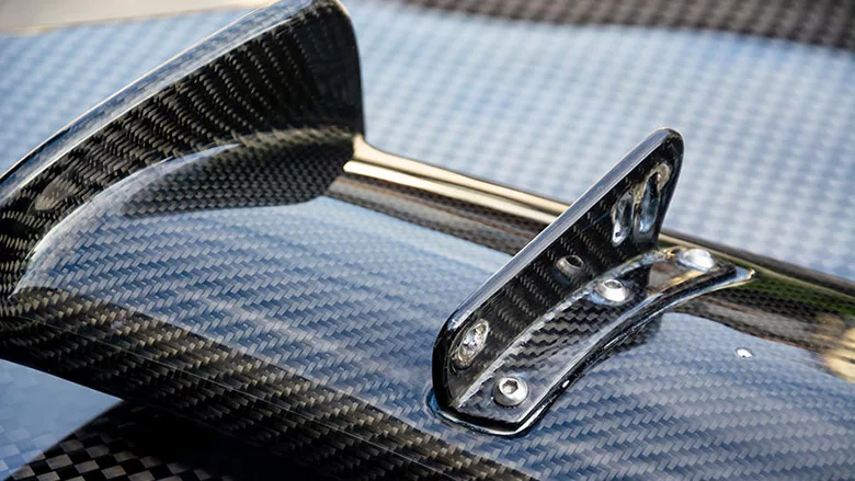

Traditionally, either fasteners or adhesives have been used to join metal parts to carbon fiber-reinforced thermoplastic (CFRTP).
However, both methods have limitations. To use fasteners, holes must be drilled in the composite, which interrupts the continuity of the fibers. Fasteners also add weight to the assembly. Adhesives require surface preparation and long curing times. The bonded joint is also sensitive to the environment.
