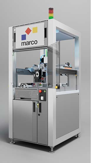

The latest error-proofing tool from Marco is the StepDot Dispensing Head, a system that combines ultra-fast dispensing with synchronized camera feedback. While the piezo valve dispenses, a camera tracks movement and verifies results live, with image analysis handled on Nvidia Jetson.
“With our new Gantry System, camera-based correction takes over fine positioning, adjusting alignment dynamically to hit sub-100 micrometer targets,” explains Herbstritt. “As a result, we deliver a fast, adaptive dispensing application with closed-loop verification.
“We use high-precision piezo valves that deliver consistent dosing, even at high speed,” says Herbstritt. “Every dispense is monitored in real time by integrated cameras with controlled lighting to ensure contrast and visibility across different surfaces. Image analysis is processed directly on the system using Jetson, allowing us to detect issues without latency.

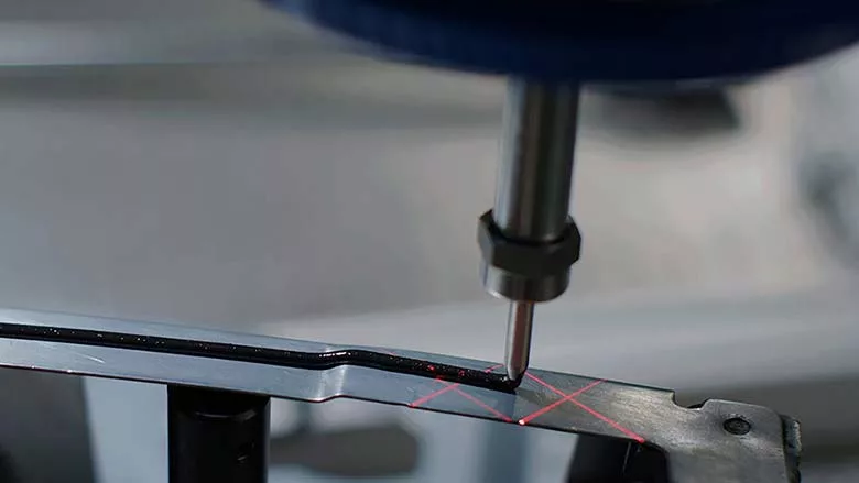

“To capture 3D characteristics such as height variations, we use a pulsed red laser,” Herbstritt points out. “Our bubble sensors check for trapped air in media lines, which is a common but critical failure source in adhesive processes. All components are synchronized by a dispensing control unit that manages triggers, controls the cameras and dosing channels, interfaces with robots and HMIs, and logs process data for traceability.”
