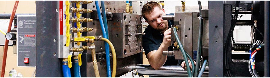

molding parts
Action Plastics molds parts for a variety of industries, primarily in the power sports, medical, and food and beverage sectors. Photo courtesy Action Plastics Inc.

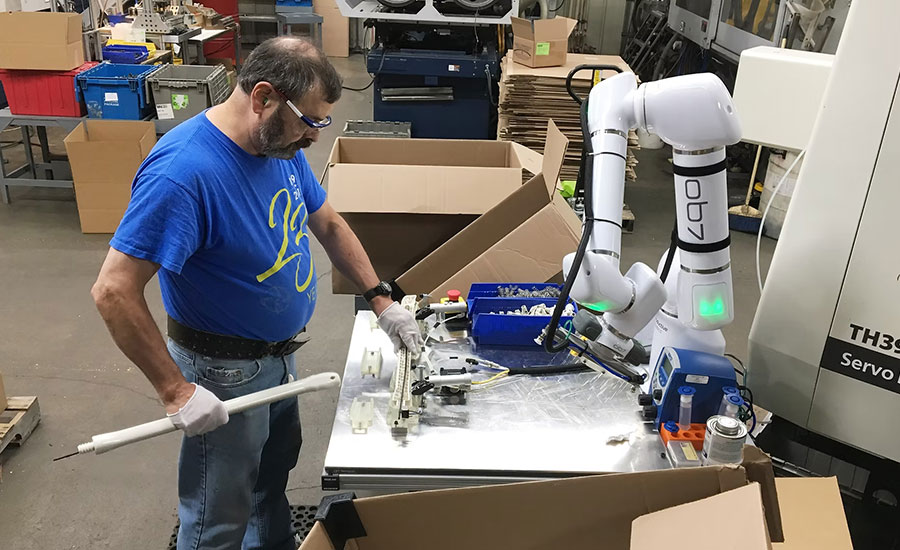

man works with cobot
By automating the dispensing and assembly processes with a cobot, Action Plastics successfully addressed its customer’s quality issues. Photo courtesy Productive Robotics
Dispensing, Assembly and Quality Control
One of Action Plastics’ customers makes a novel household plumbing tool: a combination plunger and drain snake.
Initially, the customer handled assembly of the product after it was molded, but it faced quality issues in the adhesive dispensing and final assembly processes. Adhesive would often get into inner locations of the tool, bonding components that shouldn’t be bonded. In addition, finished assemblies would be rejected due to excessive adhesive, embedded fingerprints on finished surfaces, and insufficient adhesive in the many lip and pin joints.
Engineers at Action Plastics thought they could solve those problems by taking on the assembly process and using the OB7 to automate the dispensing process at the molding press.
Shortly after, they discovered that the OB7 could automate other processes within the job to save even more time, increase efficiency, and optimize productivity.
“The flexibility really showed when we got the OB7, set it up, and started playing around with it. Our initial idea quickly evolved, and we ended up using the OB7 for something else—a new, turnkey system, actually,” explains Orstad.

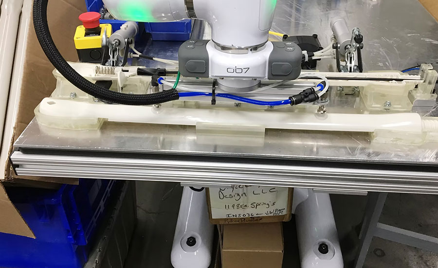

The OB7 dispenses adhesive into the lip joint and 12 pin-joint bosses on the interior of the product. Sensors were installed into fixtures to ensure the internal components were properly located and aligned prior to dispensing. The cobot provides consistent positioning and precise dispensing at each location. The cobot also performs final assembly of the product by bringing the two halves of the product together using a vacuum pump and suction cup on the end of the arm.
Thanks to the OB7’s flexibility and seven-axis maneuverability, engineers were able to teach it to automate several processes for one job. This freed up a worker to focus on critical molding processes.
Automating these processes with OB7 allowed Action Plastics to successfully address its customer’s quality issues. In the end, Action Plastics was able to provide the customer with a finished product at a much more competitive price than could have been achieved with other methods.

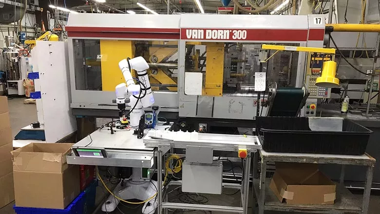

automating mid-volume assembly and production processes
Action Plastics increased productivity by automating mid-volume assembly and production processes that depended on manual labor. Photo courtesy Productive Robotics

vacuum gripper
A vacuum gripper enables this cobot to assemble the plastic handle for a plumbing product. Photo courtesy Productive Robotics
