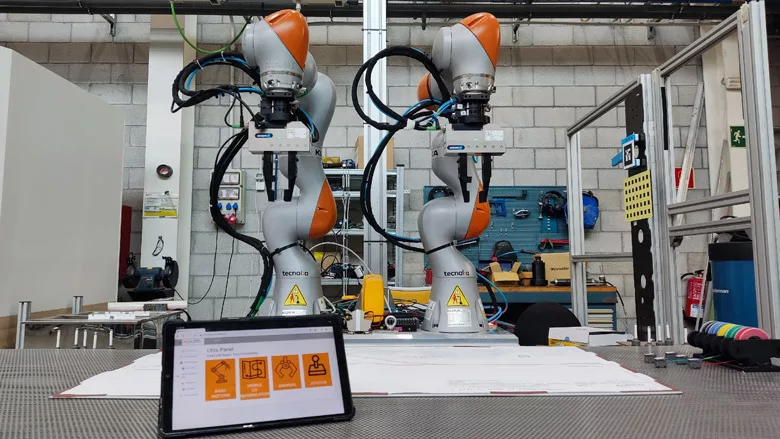

two cobots from Kuka Robotics
Photo courtesy Basque Research and Technology Alliance
The researchers’ system consists of two cobots from Kuka Robotics.

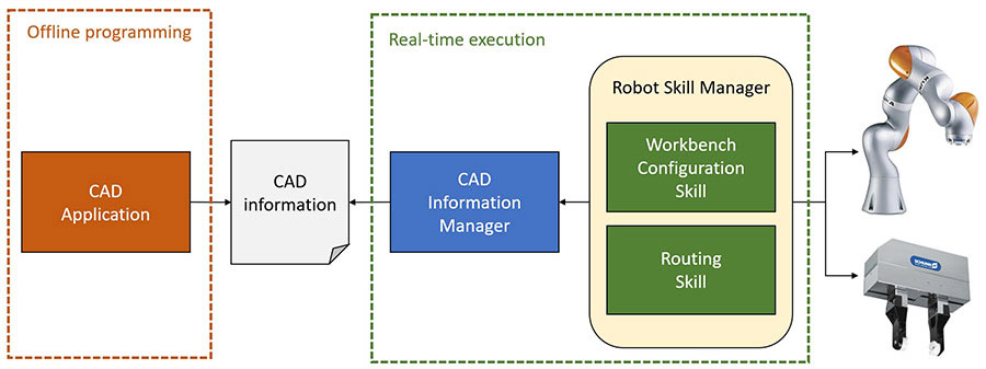

two-step workflow
The authors propose a two-step workflow: offline programming for data extraction from CAD models, and real-time execution of robot tasks based on CAD data. Photo courtesy Basque Research and Technology Alliance
Proposed Approach
We propose a system to carry out the initial steps of the assembly process, specifically the nail board configuration and cable routing. Our goal is to offer a complete system linking CAD-based robot programming with real-time task execution. Thus, we propose a two-step workflow: offline programming for data extraction from CAD models, and real-time execution of robot tasks based on CAD data.

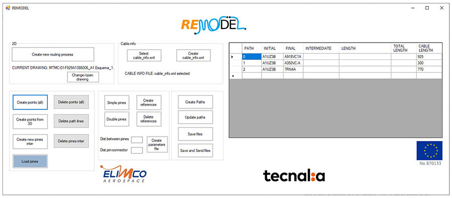

In the initial phase, an Offline Programming Framework assists engineers in defining the main elements of the wire harness, such as wire paths, endpoints and pin placement points. The module allows engineers to interact with the CAD models, extracting information by clicking on the 2D drawing of each reference. As a result, several XML files are generated for the Real-Time Execution Framework of the robotic system.
In the second phase, the Real-Time Execution Framework acquires the information generated in the offline programming phase and uses it to configure the board and route the cables. Specifically, the framework includes two modules, one to load the CAD information and transform it into the robotic coordinate system, and a second offering workbench configuration and routing skills. These modules interpret the CAD information and reconfigure robot trajectories in real time based on the received data.

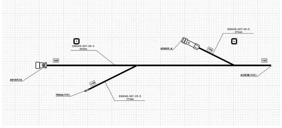

The starting point of manual wire harness assembly is a 2D CAD drawing of the harness. Our goal is to use this same drawing to program the robot, using the offline programming paradigm. Specifically, we created software to interact with the CAD software and extract information about the positions of the harness to be sent to the robotic system.
During manual assembly, workers pay particular attention to the endpoints, as well as to the intersections. Therefore, the application allows defining these points intuitively in the drawing just by clicking on the desired position. It will generate a set of points in the CAD coordinate system, where each of the points is defined by a translation vector. As the application uses a 2D drawing, all the Z values of the vectors are set to 0. Even so, any desired value could be assigned to the vectors’ Z element, creating different layers. These points will be used both for cable routing as well as for CAD calibration in further steps.
Once all the relevant points are specified, the user will be able to define different paths along the points, describing the possible routes for the cables in the wire harness. Thus, a set of paths will be generated where each path is a subset of the point set and defines the complete cable route from start to end.
Finally, each of the cables of the wire harness is assigned to a specific path. As each cable has a unique identifier, a list of pairs will define the assignation of each wire to a unique path. The sets of points, paths and pairs will be exported in XML format to be exploited by the Real-Time Execution Framework.
2D drawing of a wire harness
This image shows a typical 2D drawing of a wire harness. Photo courtesy Basque Research and Technology Alliance

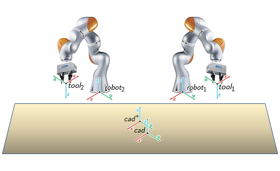

Nevertheless, it is necessary to calibrate the robot setup to have knowledge of the geometric information of the different elements of the dual-arm robotic layout. Specifically, the following transformations and coordinate systems are defined in the robot cell.
First, there is a nominal CAD origin in the workbench, which is calibrated for each robot of the dual-arm system. Therefore, homogeneous transformation matrices define both the position and orientation of the nominal CAD origin in each robot’s base frame.
As it is complex to manually place a 2D drawing precisely in the robot cell’s CAD origin, the Real-Time Execution Framework includes a CAD calibration step. This CAD calibration will calculate the offset between the nominal CAD coordinate system and the real CAD origin, an offset generated due to small errors in the placement of the drawing on the board. A transformation matrix represents this offset both in translation and orientation.
software interacts with the CAD system to extract information about the positions of the wire harness
The authors developed software to interact with the CAD system and extract information about the positions of the wire harness to be sent to the robotic system. Photo courtesy Basque Research and Technology Alliance

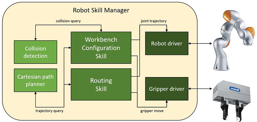

Finally, the Real-Time Execution Framework relies on two modules to perform the different tasks to configure the workbench and route the cables.
The CAD Information Manager manages all the CAD data received from the Offline Programming Framework in XML file format. Specifically, the module loads the XML files and offers different queries to get information about pin positions and routing paths. Additionally, due to errors in the positioning of 2D drawings on the workbench, this module provides a function for calculating the offset matrix based on the position of calibration points in the drawing and the position of the robots.
The Robot Skill Manager manages the robots and grippers, offering different skills to perform each step of the assembly process. Specifically, there are two skills available: configuration of the workbench by placing the routing pins in the selected points of the CAD drawing, and routing the cables based on the defined paths.
calibrating the system
Before the robots can install pins and route wires, the system must be calibrated. Photo courtesy Basque Research and Technology Alliance

Our system was implemented on a real setup to validate our approach. Our setup consists of two articulated robots equipped with parallel grippers to manipulate both pins and wires. An important aspect of the setup is the capability to sense and control the applied forces and execute compliant movements to ensure the quality of the tasks.
Two LBR iiwa 7 robots from Kuka Robotics are the workhorses of the system. These lightweight, seven-axis cobots are equipped with torque sensors in each joint. Both arms are placed side by side in front of a workbench for wire harness assembly. The compliant capabilities of the robots allow them to execute force-controlled movements; this ensures safe execution of movements for pin placement and cable routing, avoiding damage to the parts due to excessive force.
Each robot is equipped with a WSG 050-110 gripper from Schunk. These servo-electric grippers have a maximum stroke of 110 millimeters and a maximum gripping force of 80 newtons. The gripper fingers are custom-made with a planar shape. Both sides are covered by a thin foam to protect the cables, and both sides have a vertical groove to grip the pins.
Additionally, the setup includes several components related to harness assembly:
  • Workbench where all the elements of the wire harness are placed and managed.
  • A metal sheet where operators place the CAD drawings.
  • Pins, 60 millimeters long, equipped with a magnetic base that can be attached to the metal sheet.
  • Two pin trays placed near each robot.
  • A cable feeder consisting of five cable rolls, placed on a side of the workbench. The tip of each cable includes a small clip with magnets to facilitate gripping by the robot.
Additionally, the system includes several features that take advantage of the robot hardware and improve the process:
  • Compliant motion for both pin placing and cable routing. Each pin and cable grasp and release movement includes compliance in the Z axis to avoid excessive forces that could damage the part. The routing paths also include compliance in the X and Y axes to facilitate routing and alleviate the effects of entanglements.
  • Variable gripping force ensures a suitable grasp for both pins and cables without any damage to the parts.
Robot Skill Manager

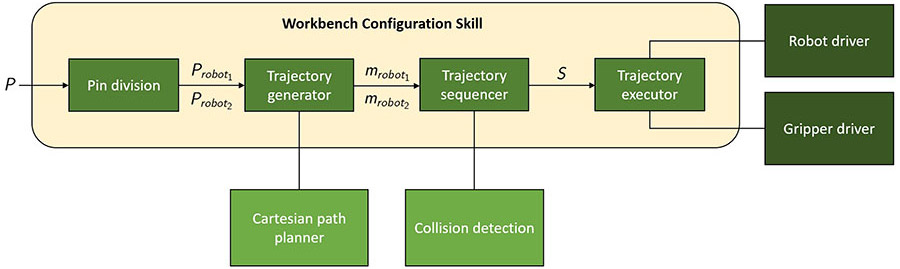

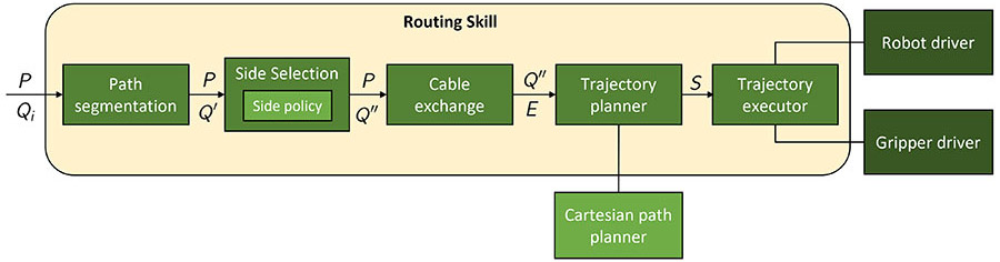

The Robot Skill Manager includes internal modules to assist the robots in configuring the nail board and routing the wires. Photo courtesy Basque Research and Technology Alliance

programming for configuring a nail board
This diagram shows the programming for configuring a nail board. Photo courtesy Basque Research and Technology Alliance
programming for routing wires
This diagram shows the programming for routing wires. Photo courtesy Basque Research and Technology Alliance
