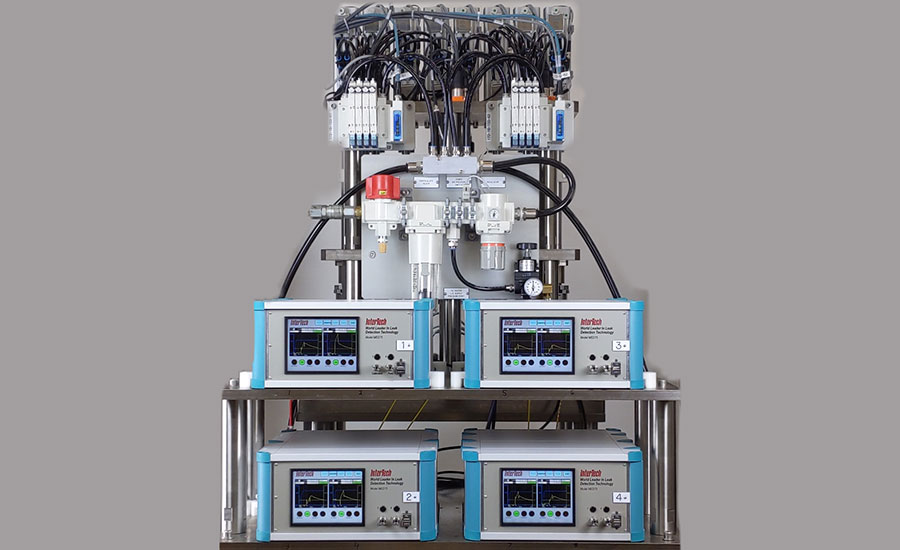

leak testing instrument
Photo courtesy InterTech Development Co.
Superior Technology
These turnkey microleak testing systems can be used for both in-line testing and audit testing. At the core of each system is InterTech’s patented mass-flow test sensors, superior pressure decay test sensor designs, and unique test fixtures.
InterTech’s MicroScale leak test technology effectively eliminated the testing errors (both false positives and false negatives) inherent in the pressure testing methods that the company had previously used. Faster throughput was achieved by replacing inefficient test instruments with InterTech MED75 MicroScale leak testers, which feature dual, independent test channels.
The instruments can reliably find holes as small as 0.5 micron in diameter.
Ethernet-IP capability allows seamless integration of test data with all the company’s quality assurance systems. This remote access to test data also led to significant savings in maintenance and product changeover times.
A robust product quality traceability system was assured by implementing a deterministic analytical test technology life cycle. The InterTech leak test systems are compatible with all ASTM standards, including ASTM F2338 and ASTM F3287, as well as being 21 CFR Part 11 compliant.
