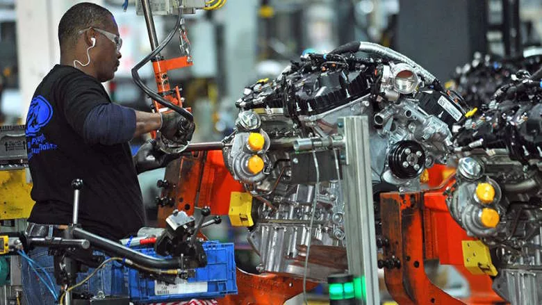

worker fastening a part to an assembly
Photo courtesy Ford Motor Co.

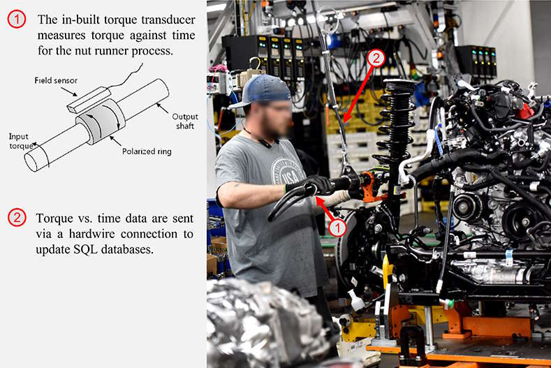

assembler uses a DC electric nutrunner to tighten a bolt on an engine
An assembler uses a DC electric nutrunner to tighten a bolt on an engine. Photo courtesy Ford Motor Co.

Detecting anomalies when tightening threaded fasteners is challenging. Yes, a transducer in the nutrunner can measure torque and angle over time, and that data can be analyzed to detect process anomalies. The challenge lies in the variability of that data.
An engine contains numerous fasteners with different thread forms, torque and angle specifications, and run-down times. Normal variation in the parts can create different torque and angle signatures. A handheld fastening tool might produce different data than a set of fixtured spindles. A person may pause for a short period between fastening stages, causing normal torque measurements to shift in time. Similarly, an automated process might pause between assemblies for tool changes or geometrical differences between product variants.
This variability in both normal and anomalous data makes traditional unsupervised clustering approaches, such as one-class support vector machines (SVM) and PCA ineffective, since anomalies are not always outliers. Reconstruction methods, such as encoder-decoders, are also infeasible because the data can shift in time at multiple stages, making it difficult to draw probability distributions.
