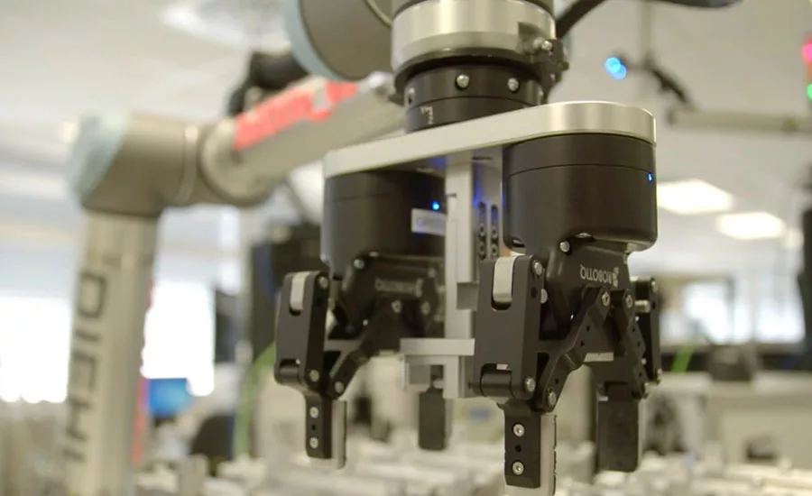

A cobot equipped with a pair of grippers loads and unloads avionics from an automated test cell.

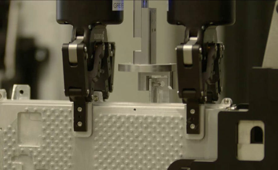

Gripping force is adjustable to avoid damaging the assembly’s aluminum housing and the electronics within. Photo courtesy Robotiq

“These computers are fragile, and they weigh 4 kilograms with an asymmetric center of gravity,” explains Marvin Plantius, CEO of KPI Engineering. “We were looking for equipment with adjustable force to avoid damaging the aluminum housing and electronics within. We also needed highly repeatable accuracy despite the 4-kilogram payload.”

KPI chose a pair of Robotiq 2F-85 adaptive two-finger grippers and a FT 300 force-and-torque sensor to handle the computer case.
The 2F-85 is adaptable and versatile. Stroke, speed and force are programmable. Maximum stroke length is 85 millimeters, and it can produce a grip force of 20 to 235 newtons. Designed to pick up a range of objects, the device allows for both encompassing and pinch grips. Replaceable fingertips enable engineers to match the gripper to the part. The gripper can carry a maximum payload of 5 kilograms.
“We needed a very flexible gripper with which we could easily monitor force and the distance between two points,” says Plantius. “The 2F-85 was an obvious choice. The big advantage of the force-and-torque sensor is that you can record complex movements with the path-recording function. Force can be monitored for critical movements, such as when components contact the parts trays.”
Diehl chose a Universal Robots UR10 six-axis cobot, which has a load capacity of 10 kilograms and a reach of 1,300 millimeters, for the project. It was the first time a cobot had been deployed at the Überlingen factory.
“It matched the environment really well,” says Plantius. “We wanted a cell design that takes very little space in an open area. We established a safety perimeter with sensors that slow down or stop the robot when a human is detected within a specific distance from the robot. This is a great alternative to caging, and it meets the highest safety standards. Plus, the components from Robotiq are UR+ certified, which simplifies integration with Universal Robots. They are coordinated in terms of hardware and software, which allows us to operate the grippers and force sensor directly via the controller.”

Designed to pick up a range of objects, the gripper can perform both encompassing and pinch grips. Replaceable fingertips enable engineers to match the gripper to the part. Photo courtesy Robotiq

Once this operation is done, the computer is placed in the testing unit. The pair of grippers ensures that the computer is placed in the tester in the exact same position every time. The robot then closes a lever, and the testing phase starts. After testing is complete, the robot unloads the computer, and the process repeats.
