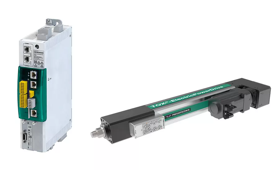

Tox ElectricDrive press
Photo courtesy Tox Pressotechnik
The electromechanical Tox ElectricDrive is an energy-efficient, precise, low-maintenance machine equipped with force and stroke control.

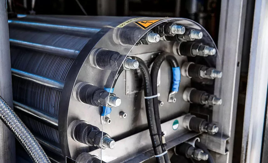

electrolyzers split water into hydrogen and oxygen
Electrolyzers split water into hydrogen and oxygen using electricity.

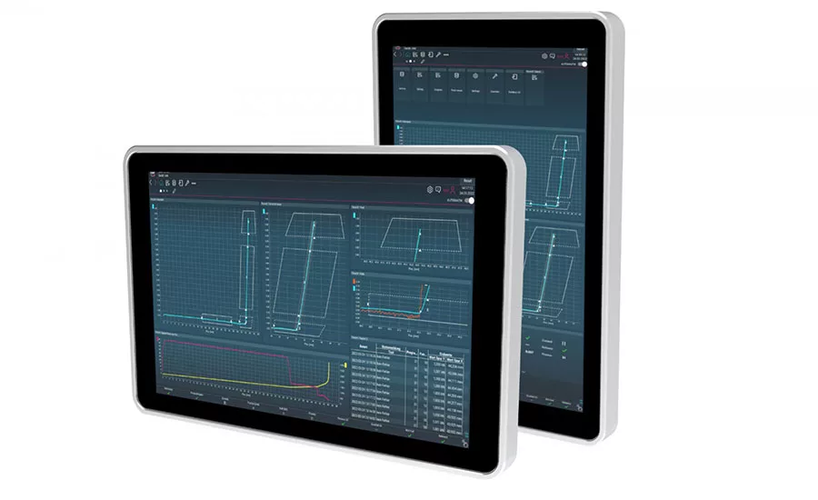

controller monitors force and ram position during the pressing process
To ensure quality, the controller monitors force and ram position during the pressing process.

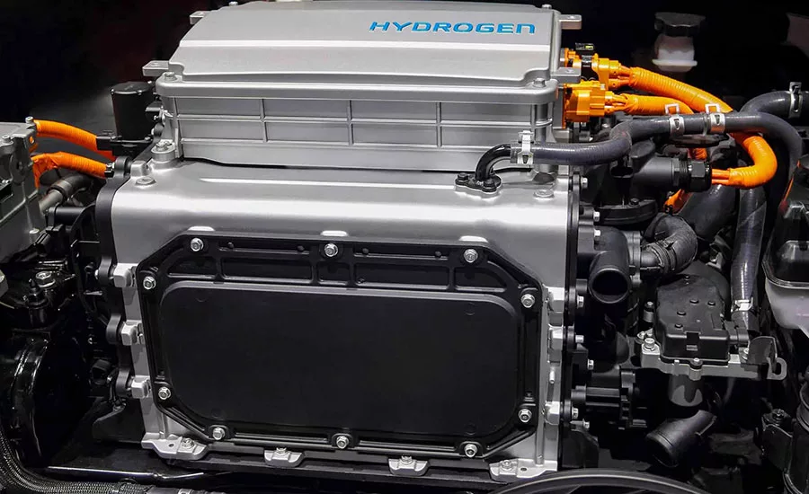

fuel cell
Fuel cell stacks convert hydrogen from a tank and oxygen from the air into electric current.

The electromechanical Tox ElectricDrive is an energy-efficient, precise, low-maintenance machine equipped with force and stroke control. Press force ranges from 0.02 to 1,000 kilonewtons. The press can be integrated quickly into automated assembly lines thanks to its preconfigured and calibrated operating system.
