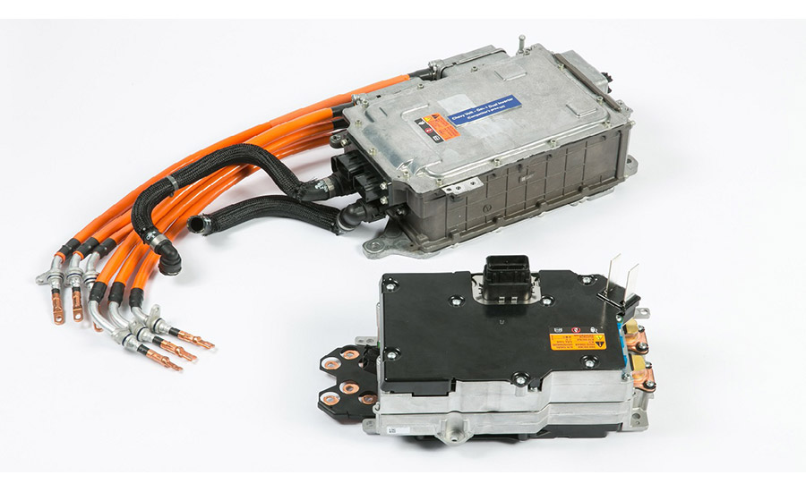

A key challenge of manufacturing EV components, particularly power electronics, is how to keep them cool. For many applications, BorgWarner uses thermal paste.
Also known as thermal grease or thermal interface material, thermal paste is a thermally conductive (but usually not electrically conductive) compound that is used as an interface between heat sinks and heat sources, such as high-power semiconductor devices.
Despite its name, thermal paste does not actually bond the heat sink to the heat source. Instead, screws or other fasteners must be used to hold the heat sink in place and to apply pressure to the joint, spreading and thinning the paste. (A thermally conductive adhesive would bond the heat sink.)

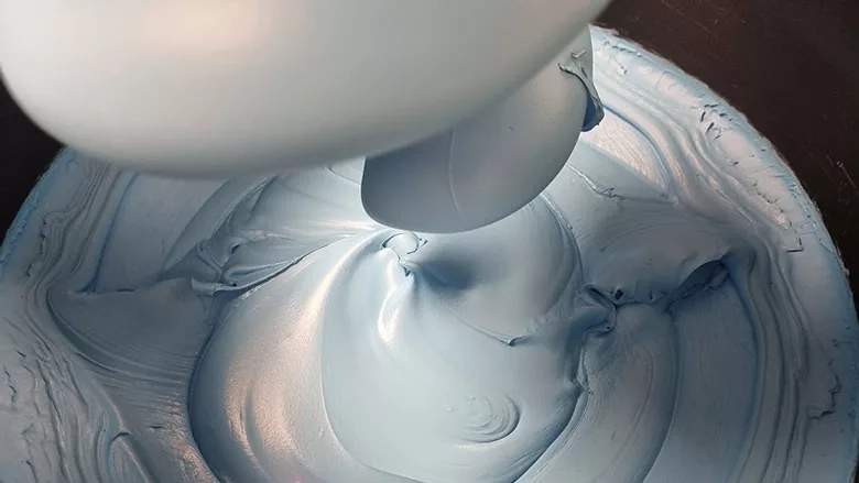

Thermal paste is formulated to maximize heat transfer and dissipation. It is made from of a polymerizable liquid matrix combined with an electric insulator as filler. The filler, which represents 70 to 80 percent of the paste’s total mass, also conducts heat. The filler may be made from aluminum nitride, aluminum oxide, boron nitride, diamond or zinc oxide.
Dispensing Thermal Paste
For thermal paste to work, it must be dispensed in just the right amount. Too little, and the material will be less effective. Too much, at it will simply flow out from the joint, creating a mess. It’s also important for the heat-conductive particles to be evenly distributed throughout the material. In addition, the paste must not contain bubbles, since air acts as a thermal insulator.
Unfortunately, inconsistent dispensing of thermal paste was exactly the problem BorgWarner was facing. BorgWarner received the paste in hobbocks—large metal buckets with handles on opposite sides. Feeding the material from the bucket directly to the point of dispensing was impossible. Besides noticeable separation behavior, the thermal paste exhibited significant cracks when it polymerized.

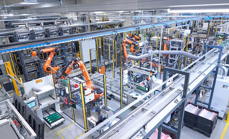

BorgWarner manufacturing facility
Operating 92 manufacturing facilities in 24 locations worldwide, BorgWarner tallied sales of more than $14 billion in 2024. Photo courtesy BorgWarner

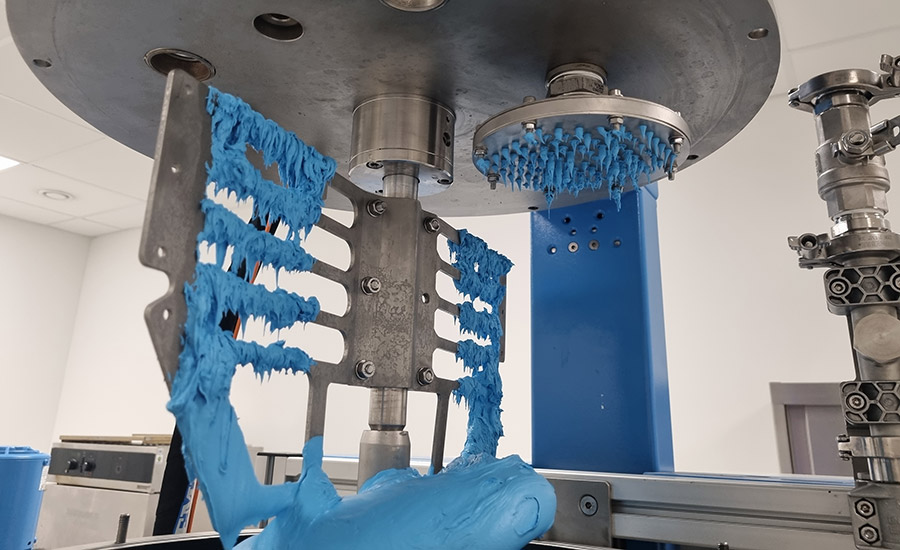

The ViscoMT-XS feeds the paste from the hobbock to the ViscoTreat-I, which stirs and degasses the material. The paste enters the ViscoTreat-I via a media distributor, a nozzle resembling a showerhead. Inside the ViscoTreat-I, a stirring mechanism ensures even distribution of the conductive particles and gets rid of any air bubbles.
Once it is bubble-free and well-mixed, the paste is smoothly delivered to the dispensing valve.
